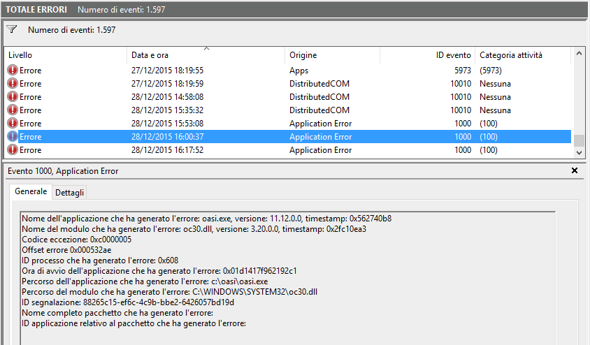

  2. OC30.DLL Access Violation
    I have an old software, written in Visual Basic 6.0.
    Some users have upgraded to
    Windows 10.
    After upgrading, the software sometimes
    crashes and in the event log I find
    a report of access violation in OC30.DLL.
    I tried to set the exe compatibility
    to Win 7 or Win8 but I did not get
    any results.
    Yes, the dll is very old
    butlthe error is completely new :-(.
    hpbxpsv429.dll access violation in printfilterpipelinesvc.exe 10eb2262-2bfe-4fb3-b635-d638f810630e.png
    FrancescoRX, Mar 23, 2020
