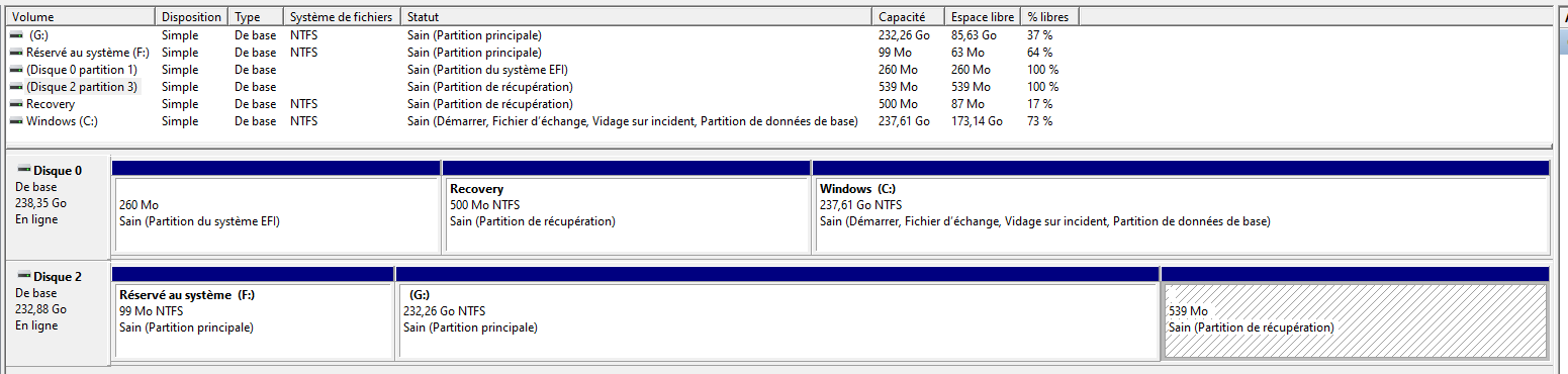

Discus and support I accidentally deleted the partitions on a C: drive, restored them, but now it won't boot. in Windows 10 Installation and Upgrade to solve the problem; TLDR: title. Behold my disk manager screenshot pardon my french, where Disk 0 is my laptop's C: drive, which is normal, and Disk 2 is the patient. As... Discussion in 'Windows 10 Installation and Upgrade' started by Brian le Bref, Oct 11, 2020.
  1. I accidentally deleted the partitions on a C: drive, restored them, but now it won't boot.
    TLDR: title. Behold my disk manager screenshot pardon my french, where Disk 0 is my laptop's C: drive, which is normal, and Disk 2 is the patient. As you can see, the partitions are not the same.
    I accidentally deleted the partitions on a C: drive, restored them, but now it won't boot. 5779ea63-2aae-4a37-88e9-de4651af9162?upload=true.png
    Details:
    So i want to upgrade from my old 2.5 SSD to an M2 SSD; i plug them both into my computer to image the old to the new; i remember that i've used the new M2 before, so i open the default Windows drive manager to delete its partitions; and that's when i boneheadedly delete the partitions on my old 2.5 SSD instead.
    Undeterred by my stupidity, i install Active Undelete to restore them; it works, all the partitions are back, the files are there, as far as i can tell my old 2.5 SSD is ready to work again. Install it into the computer to check, attempt to boot... And it doesn't work, it tries for a few seconds then sends me back to the BIOS screen. Clearly, deleting and restoring the partitions has broken something in Windows.
    I then download Windows Media Creation Tool, install Windows on a thumb drive, and try to use the Recover function that it has, hoping that this will unfuck the OS. It doesn't, it just bluntly tells me that it has failed with no further explanation. There's a command prompt available, but i don't know how to use those. I have taken a few pictures of this with my phone.
    Of course i could just install a fresh Windows, but i don't want to for reasons both practical re-install a lot of apps and settings that i've mostly forgotten and sentimental this has been my home since 2015, i don't wanna start fresh.
    My goal is to get this old 2.5 SSD back to a bootable state so i can then image it to the new M2 SSD. Google and this forum hasn't been helpful mostly how to create restore points hence why i find myself before you.
    Thank you for your help :

  4. I accidentally deleted the partitions on a C: drive, restored them, but now it won't boot.
    Accidentally deleted Windows 10 boot partition. How do I restore it?
    Hi.
    You can create a lost/deleted EFI partition by CMD.
    1) Create an installation media
    2) Boot PC with an installation media
    3) Press SHFIT + F10 on the first screen to bring up Command Prompt
    4) Run the following commands and click Enter each time at Command Prompt:
    diskpart
    list disk
    select disk N (N refers to the disk which contains the deleted the EFI System partition)
    list partition
    create partition efi
    format quick fs=fat32
    list partition
    list volume (find the volume letter which belongs to the installed Windows OS)
    exit (exit diskpart)
    bcdboot M:\windows (M refers to the volume letter of installed Windows OS)
    (bcdboot m:\windows command will copy the boot files from Windows partition to the EFI system partition and create BCD store in the partition)
    Next remove installation drive and restart your computer
    Let me know if you have any questions
    Mark St..., Oct 11, 2020
