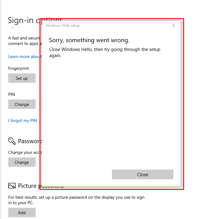

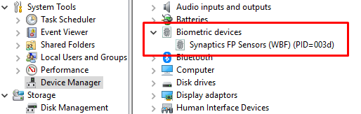

    I am trying to setup fingerprint on my HP Elitebook 8470p, but Windows Hello says " Sorry, something went wrong. Close Windows Hello, then try going through the setup again." I install the latest version of Synaptics fingerprint driver.
    I am facing a problem to setup fingerprint on Windows Hello. 254d6f14-ff49-45e0-a599-35e16ea5aeea?upload=true.png
    But when I am going to setup fingerprint every time I am getting the same issue.
    I am facing a problem to setup fingerprint on Windows Hello. 88add28c-8eac-41dc-ad19-2aa930a71da5?upload=true.png

    It's odd for your fingerprint not to work after your computer wakes up from sleep mode. The power management settings could have something to do with it. Let's isolate your concern by modifying the power management through Device Manager. Simply follow the
    steps below:
    • Right-click on the Windows icon on your computer, then select
      Device Manager.
    • locate your fingerprint reader, it should be in Biometric Devices section.
    • Right click the fingerprint reader, then choose Properties.
    • Navigate to Power Management tab, then uncheck Allow the computer to turn off this device to save power.
    • Click OK.
