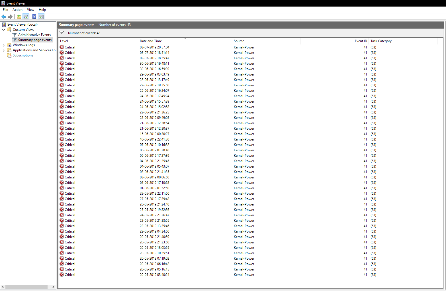

    The list of events since the system was first turned on :
    I am getting occaisonal shutdowns during boot and a lot of event ID 41 critical errors... 5cf0f43c-a72b-4fda-ba5b-cf74bd91e82c?upload=true.png
    Some of the events above have been registered even when I had no shut down during the startup .

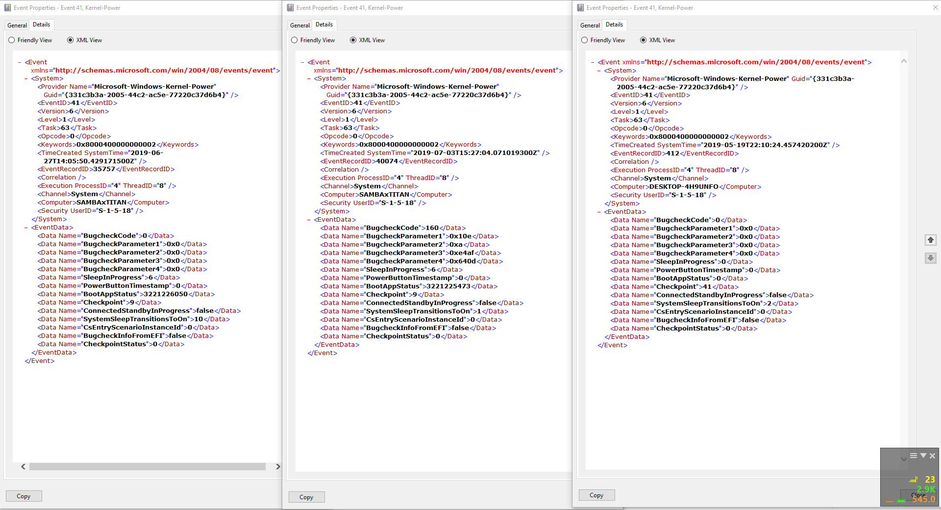

    While there are so many events but the event details seemed to be limited to these :
    I am getting occaisonal shutdowns during boot and a lot of event ID 41 critical errors... 18fb1078-2779-485f-b8df-6c9706f3c535?upload=true.png I am getting occaisonal shutdowns during boot and a lot of event ID 41 critical errors... 418462cd-fc92-4c88-ae9a-f816f09f8b5a?upload=true.png

  2. Kernel-Power event id 41. BugcheckCode 0
    In-order to get more clarity on this issue and to assist you with appropriate troubleshooting steps, reply with answers to the below questions:
    1. Are you aware of any changes made on your PC, prior to this issue?
    2. Is this issue specific while playing a particular game?
    3. Which edition of Windows are you currently using?
    A Kernel Power Event 41 can occur in the following scenarios.
    Scenario 1: The computer restarts, and there is a Stop error BugcheckCode in the event data.
    Scenario 2: The computer is shut down by pressing and holding the power button.
    Scenario 3: The system randomly restarts and no Stop error BugcheckCode is listed, or the computer is completely unresponsive (hard hang).
    I suggest you refer the article on Kernel
    Power Event ID 41
    and follow the steps for the scenario that is causing this error on your PC.
    Additionally, you can refer the article on Windows
    Kernel event ID 41 error "The system has rebooted without cleanly shutting down first" in Windows
    and check if that helps.
