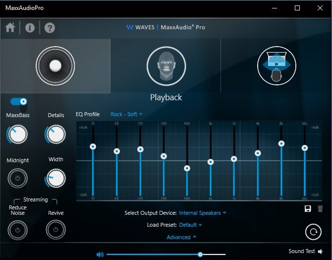

  4. sandyt Win User
    I am having issues with finding the loudness equalization settings to adjust the release...
    Loudness Equalization issue
    Dell disables realtek's loudness equalization function because Waves MaxxAudio provides you with Midnight. They don't want you to mistakenly enable both at the same time and ruin your sound.
    I am having issues with finding the loudness equalization settings to adjust the release... 313951d1610128754t-loudness-equalization-issue-s1.png
    sandyt, May 25, 2023
