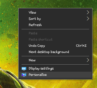

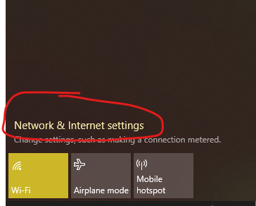

    I cannot open Windows Settings through any shortcut methods c884dbb3-0eff-4b4d-9bbb-32caf5b11014?upload=true.png I cannot open Windows Settings through any shortcut methods d6130ef1-6dcd-4079-9f09-6a51fb07d3d4?upload=true.png
    I cannot use any of these shortcuts Display Settings through either Desktop>Right Click>Personalize, Network & Internet settings or by using Notifications inAction Center it suddenly pops up a cmd window and closes itself within a sec.
    Using settings through start menu would work...
    Tried ending Explorer and opening again... It does ur didnt work after i restarted the process.
