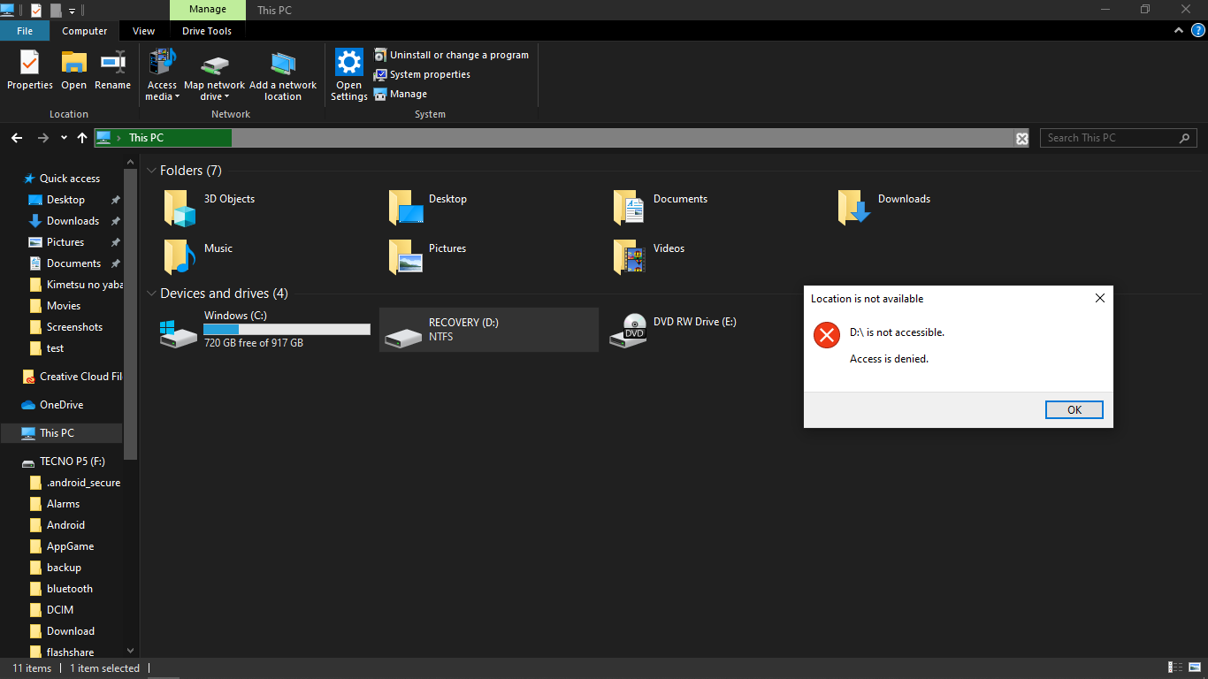

    Hello, please I really need your help.
    I can't access my recovery storage on windows 10. I scanned using chksdk and no error came up, tried permission access but nothing positive came up. Please help
    I can't access my recovery storage 054c42d5-08c8-4668-9c17-91a6a445a393?upload=true.png

  3. topgundcp Win User
    How does Windows boot to advanced recovery option e.g. command prompt?
    - that gives me a 454 'Unexpected error' This tells me that the BCD is partially corrupted.
    The commands: shutdown.exe /r /o /f /t 00
    or: %SystemRoot%\System32\Cmd.exe /c reagentc /boottore&shutdown /r /f /t 00
    should boot into Recovery if everything is configured correctly.
    FYI, If Windows is configured correctly:
    1. If Reagentc is disabled, you still can get into Recovery but with limited options.
    2. If Reagentc is enabled, you'll get all options.
    3. If you boot Windows using Recovery USB stick, You'll get into Recovery with couple of options missing.
    Here's my suggestion if you want to try:
    OPTION 1: Will save the trouble of re-install Windows.
    1. Download the image of my first 3 partitions (450MB Recovery, 100 MB EFI partition, and 16MB unformatted primary)
      EFI_Boot-00-00.7z - Google Drive
    2. Run Macrium and restore the image from step 1, overwriting your existing 1st three partitions, leaving C alone.
    3. Delete the 490MB Recovery partition.
    4. From Macrium, run fix boot problems.
    5. Reboot. Open Admin command prompt then run Reagentc /info to make sure that it is enabled. If not, enable it.
      if failed to enable, reboot and try again.
    OPTION 2: Assuming you've already had Windows backup with Macrium.
    1. Wipe out the first 5 parttiions. (450MB, 100MB, 16MB, C Drive, 480MB)
    2. Fresh install Windows 10
    3. Restore C drive from backup image, run fix boot problems
    4. repeat step 5 from OPTION 1 above.

  4. bhaalkc Win User
    Help accessing recovery partition
    if he deleted the recovery partition, you wont be able to access it. You will have to reinstall Windows from dvd or cd.....
    bhaalkc, Jun 23, 2020
