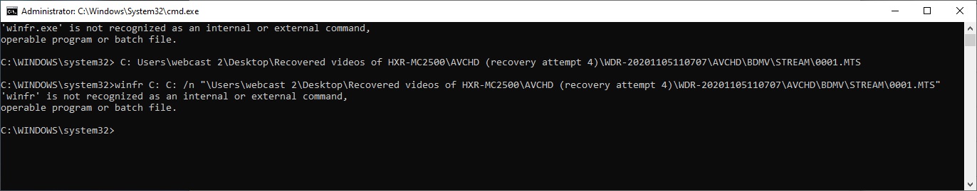

  1. I can't get "Windows File Recovery" app to run on my PC.
    I can't get Windows File Recovery app winfr.exe to run despite my PC having Win10Home 64bit, v2004 build19041.610
    According to the CMD that appears, "winfr.exe is not a recognized as an internal or external command, operable or batch file."
    I can't get "Windows File Recovery" app to run on my PC. 71774f27-a2c9-4d1d-bed4-e8788292bea0?upload=true.jpg
    I even used to the syntax guide at https://support.microsoft.com/en-us...ndows-10-61f5b28a-f5b8-3cc2-0f8e-a63cb4e1d4c4 but it still didn't run.
    Does this mean that my PC HP All-In-One 24-g014 with Intel Core i3-6100U @ 2.30GHz & 2.30GHz, 8GB RAM hasn't met all the requirements for running the winfr.exe app...or am I not doing things correctly? Thanks.
    Thanks.
