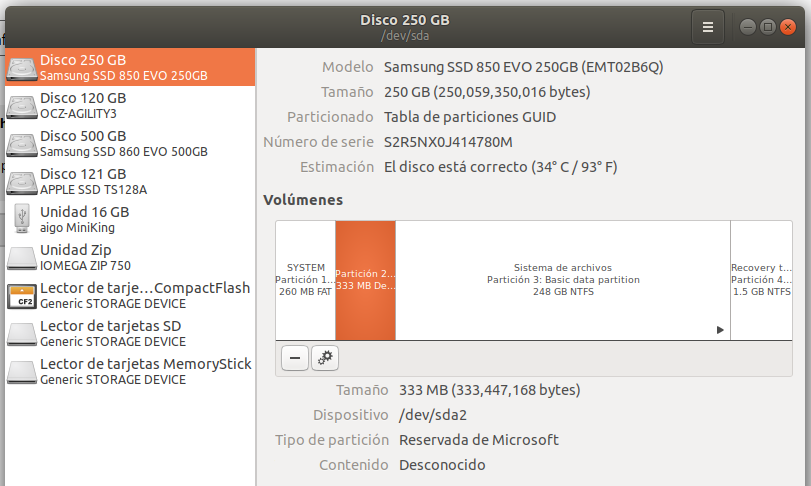

    And here's a photo of my partitions for the DISK 0 with windows 256GB ssd:
    I get a blue screen while loading windows 10 -happened after shutting down from the... afd294ce-220c-460f-a73f-e22215110e7c?upload=true.png
    Maybe I need to try the GUID ID properties command or other ID command that I've found from this site, I haven't yet. What else can I try besides everything exposed?
