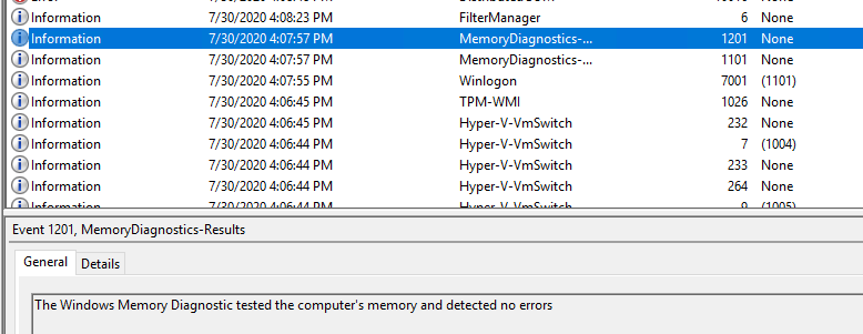

  4. WilliamDz Win User
    I need help. Event Viewer doesn't show me the results of the Memory Diagnostic tests I ran.
    Event Viewer doesn't show Diagnostic test results.
    So i double-checked by running a couple tests.
    If system passed memory test, normally in Applicatios and Services log > Microsoft > Windows > MemoryDiagnostics-Results it would only contain a single information
    entry with "Windows Memory Diagnostics results"
    However, in the System Log the more descriptive events shows under Source MemoryDiagnostics-Results, Event ID 1101 and 1201 respectively.
    I need help. Event Viewer doesn't show me the results of the Memory Diagnostic tests I ran. 14546c33-8179-4dd8-9bfa-e631eec6a06e?upload=true.png
    WilliamDz, Jul 31, 2020
