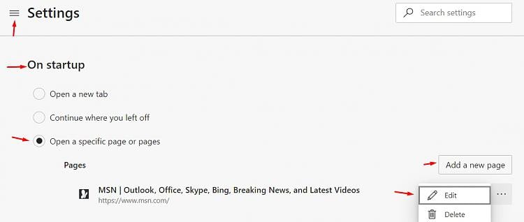

  3. mrgeek Win User
    Opening edge with set tab
    " I would like it for me to open Edge so that Outlook.com mail opens automatically in the first tab on start up or closing all tabs and selecting Edge again."
    Open your Mail in a tab, to get address, then open Settings. Hit the 3 line menu (upper L) then Startup. Use the options in screenshot. I have 2 start pages listed but you get the idea -
    I opened my settings and found that in my Windows update tab it is showing an error, I... 266145d1581135937t-opening-edge-set-tab-screenshot_1.jpg
    mrgeek, Nov 12, 2023
