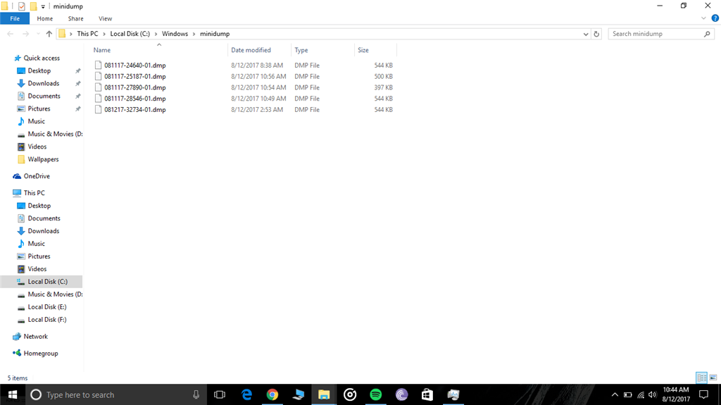

  4. I received BSOD after installing new NVIDIA graphic driver.
    BSOD's and failure to install graphic driver
    • The issue started around a week ago when I tried to update my graphics driver. I downloaded it from the official site and when I ran it, it gave me the errors "7zip Data Error" or "CRC Error". It was then that I noticed my PC has problem with installing
      softwares that involve extracting compressed data. Then a day or later I started getting the BSOD.
    • I am using the Asus R558UF laptop with the Intel 6200U 2.4GHz processor, 8 Gb DDR3 ram and nVidia GeForce 930m with 2Gb vram.
    • No, I didn't make any changes to my laptop before the problem started.
    • As far as installed programs are concerned, my program list mainly consists of the official asus drivers for my laptop, VLC media player, winrar and a couple others.
    • To resolve the issue I have re-installed my Windows 10, downloaded the driver several times and install it before installing any other program. I also booted into safe mode and ran sfc/scannow to check system files integrity but it said that there was nothing
      wrong.
      Its almost as if the file gets corrupted the minute I open it.
    • I haven't gotten any BSOD lately but I think the issue here is the failure to install the nVidia driver or any other such program.
    I received BSOD after installing new NVIDIA graphic driver. 45053d20-22a4-4dd9-a1c6-0cc1ecaeb985.png
    Abhish3k403, Dec 19, 2022
