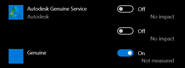

    I still see Autodesk and some other unknown apps in Startup after uninstalling AutoDesk.
    I still see Autodesk and some other unknown apps in Startup after uninstalling AutoDesk 46ec03c9-9fe8-44e6-8965-eb092680192c?upload=true.png
    I have uninstalled Autodesk using MicrosoftProgram_Install_and_Uninstall.meta tool. And also deleted Autodesk related folders from C: drive and Program Files.
    Also this Genuine app is on even after I disable it.
    GorHayrapetyan, Apr 23, 2020

    autodesk sync
    Try the steps listed below and check if it works:
    • Press Win + R keys together on the keyboard to open the Run dialog and type the following into the Run box: REGEDIT
    • Navigate to the following location:
      HKLM\Software\Autodesk\Autodesk Sync
    • Look for the entry ‘Installed Products’ and empty it.
    Note:
    Serious problems might occur if you modify the registry incorrectly. Therefore, make sure that you follow these steps carefully. For added protection, back up the registry before you modify it. Then, you can restore the registry
    if a problem occurs.
    Refer
    backup and restore registry
    to know how to backup and restore registry.
    Hope it helps.
    Junaid_A, Apr 23, 2020
  3. autodesk sync
    I have tried to unistall Autodesk Sync multiple times. Each time I have received a warning that I am unable to uninstall.
    RODNEYMILLER_1971, Apr 23, 2020
    autodesk sync
    Hi Rodney,
    An incomplete uninstallation of Autodesk Sync may cause such issues. It's important to completely uninstall Autodesk Sync and remove all it's files.
    You may boot the PC in safe mode and check if you can uninstall Autodesk Sync.
    To boot the PC in safe mode, refer to
    safe mode in Windows 10
    Hope it helps,
