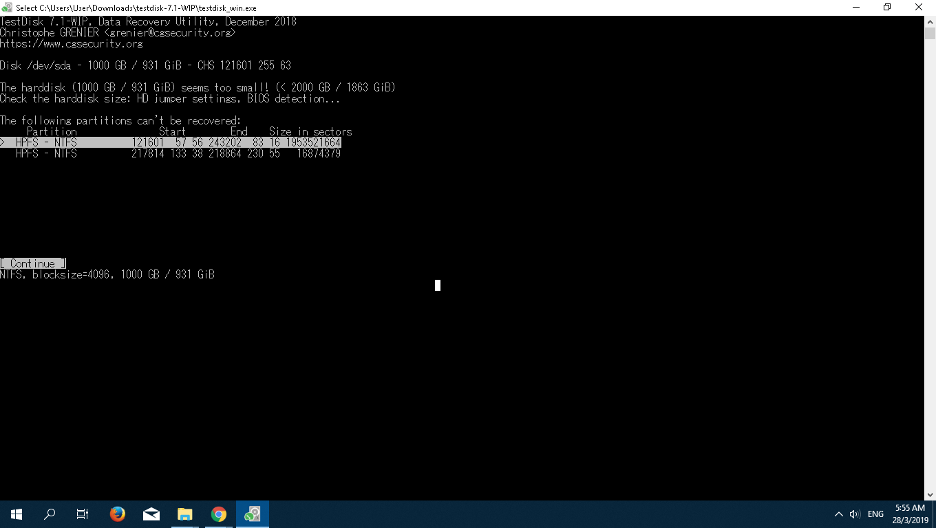

Discus and support I WAS RECOMMENDED TO USE https://www.cgsecurity.org/wiki/TestDisk_Step_By_Step AND STILL... in Windows 10 Drivers and Hardware to solve the problem; i stuck at this part after finish analyse and deep search.this is what i got after: [ATTACH] i dont know what to do next after the analyse... Discussion in 'Windows 10 Drivers and Hardware' started by Sir.Debiluk, Mar 29, 2019.
  1. I WAS RECOMMENDED TO USE https://www.cgsecurity.org/wiki/TestDisk_Step_By_Step AND STILL...
    I WAS RECOMMENDED TO USE  https://www.cgsecurity.org/wiki/TestDisk_Step_By_Step AND STILL... 6dcd0332-bfa6-4982-9c90-d1e16e2ca3d5?upload=true.png

    disk structure is corrupt and unreadable
    Oh, the program is looking for unallocated space, while yours in unformatted. I thought they were similar enough.
    I'm not sure what else to suggest. The safest thing is to use a Linux live system to copy your data out.
    See the link above. I'm surprised that the Partition Master program cannot handle this. Perhaps it is worth contacting Easeus to see what they say about the problem.
    There is a program suite called Testdisk which runs in a CMD window. It's a little complicated and will require
    some reading. The authors have provided a detailed example. to show how it works. I was able to use it
    recently to fix a partition that had an error, it was RAW when it should have been NTFS
    TestDisk Step By Step - CGSecurity
    Perhaps give this a try, see if testdisk_win.exe can identify your partition, and offer to fix it.
    Otherwise you may be forced into the Linux solution.
