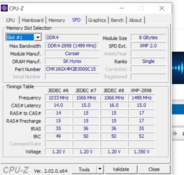

    Hi Yes all the sticks are the same brand it reverts to 2133mhz when xmp is off
    Here is the ram info they are all the same
    i9-13900k Corrected Hardware Error has Occurred 378267d1667318387t-corrected-hardware-error-has-occurred-capture.jpg
    - - - Updated - - -
    what would be your opinion if the errors are not causing a slow down or bsod would it be safe to leave on the xmp for 3000mhz.
