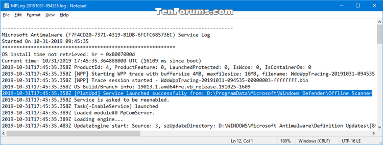

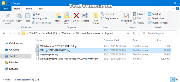

    Ok. I found the log file for a Windows Defender Offline Scan.
    It's a MPLog-YYYYMMDD-HHMMSS.log file located in the C:\Windows\Microsoft Antimalware\Support folder.
    You will notice D:\ProgramData\Microsoft\Windows Defender\Offline Scanner towards the top in the opened log file.
    I'm on Windows10.  How do I find the results for Windows Offline Scan. 253071d1572534409t-windows-defender-offline-scan-results-windows_defender_offline_scan_log_file.png
    I'm on Windows10.  How do I find the results for Windows Offline Scan. 53072d1572534415t-windows-defender-offline-scan-results-windows_defender_offline_scan_log_file-2.png
    Brink, May 25, 2023
