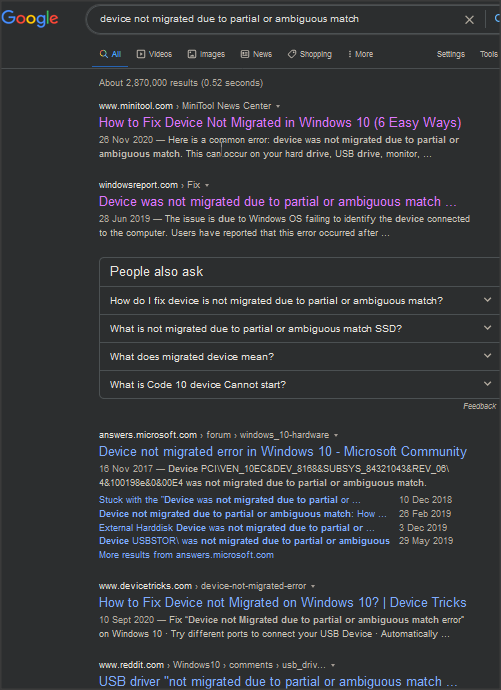

    Hi, lots of results if you search for
    device not migrated due to partial or ambiguous match
    - suggest uninstalling the root hubs and let them reinstall on reboot.
    Did this occur after a Windows update was applied? (See Update History).
