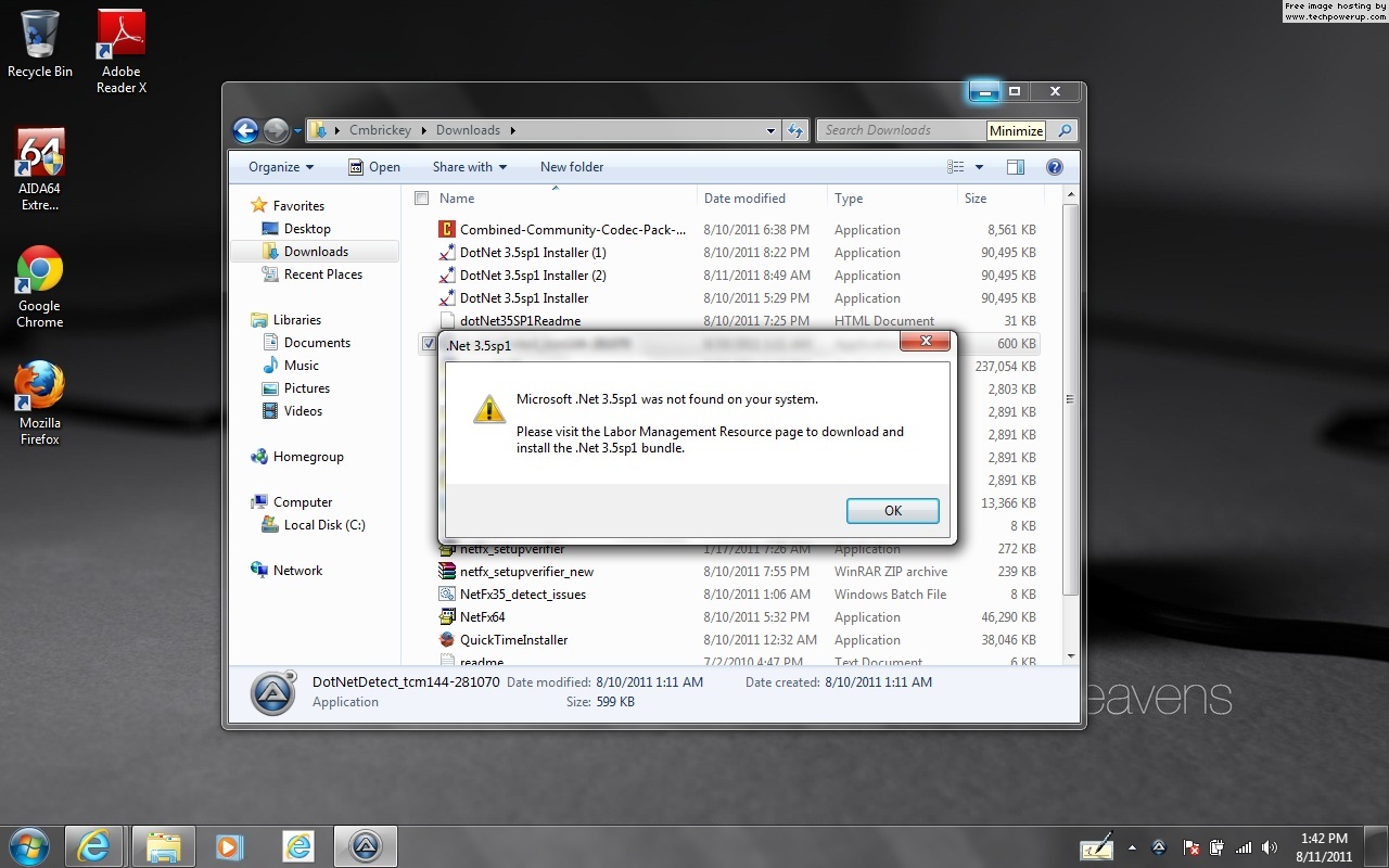

  4. install .Net 3.5 sp1 on Windows 10 Enterprise build 19041
    .net framework 3.5 sp1 not installing
    The only thing that I've ran is a .net setup verifier system. there is a 3.5 sp1 app that lets me know if 3.5 sp1 is installed via my company's System..
    install .Net 3.5 sp1 on Windows 10 Enterprise build 19041 not%20installed.jpg
    Cold Storm, Aug 17, 2020
