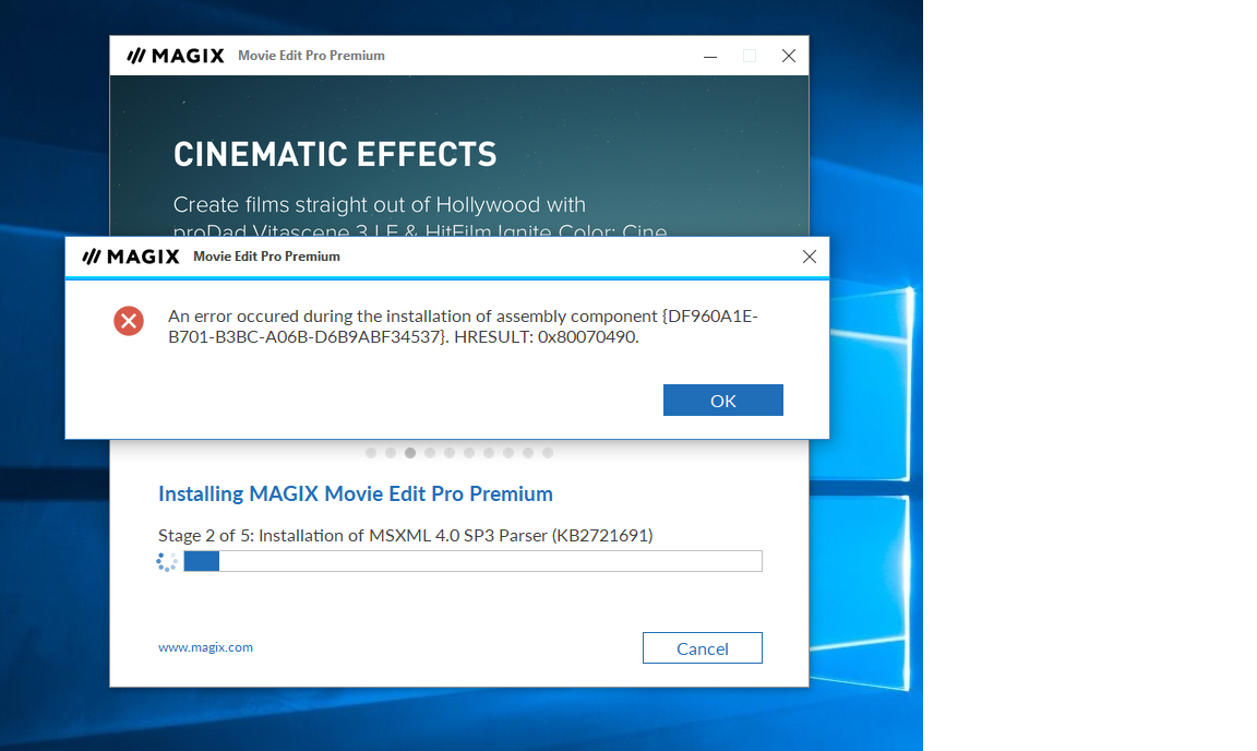

  1. Installing MSXML 4.0 SP3 Parser (KB2721691) ERROR HRESULT: 0x80070490
    please could anyone help me to get fix this error ,
    I'm going crazy
    Installing MSXML 4.0 SP3 Parser (KB2721691) ERROR HRESULT: 0x80070490 0c345864-cee7-4bdf-a6b6-9a7ea1eee895?upload=true.png
    AtefRakaibi, Aug 4, 2019
  2. Installing MSXML 4.0 SP3 Parser (KB2758694) ERROR HRESULT: 0x80070490
    Please provide some additional information, so that we can assist you better.
    1. Are you working on Domain network environment?
    2. How are you trying to install MSXML 4.0?
    Method 1: Download MSXML 4.0 from Microsoft update catalogue
    1. Navigate to the link
      https://www.catalog.update.microsoft.com/Search.aspx?q=KB2758694
    2. Click on the Download button beside Security Update for Microsoft XML Core Services 4.0 Service Pack 3 for x64-based Systems (KB2758694)
    3. Select the language in which you want to download the update.
    4. Once the .exe file is downloaded, right click on the .exe file and select
      Run as Administrator.
    5. Follow the on screen instructions to install the update.
    6. Once the update is installed restart the computer.
    Method 2: Usually, we see 0x80070490 error if there are corruption in certain components of the operating system.
    We can run the DISM command to check for the corrupted components and repair them. To run the DISM command follow the steps mentioned below:
    1. Type Command prompt
      in the search bar.
    2. Right click on the Command Prompt icon and select
    3. Copy and paste the following command in Command prompt:
      Dism /Online /Cleanup-Image /RestoreHealth
    4. Once the process is completed restart the computer.
    Method 3: Install MSXML 4.0 in Compatibility mode.
    You can try installing MSXML 4.0 update in Compatibility mode. To install the update in Compatibility mode follow the steps mentioned below:
    1. Right-click on the .exe file of the update and select "Properties".
    2. Select "Compatibility" Tab.
    3. Place a check mark next to "Run this program in Compatibility mode" and select the appropriate operating system from the drop down list.
    4. Let the update install.
    5. Once the update is installed restart the computer.
    Hope it helps.
    Let us know if you got the help you needed by clicking ‘Yes or No’.
    Harish
