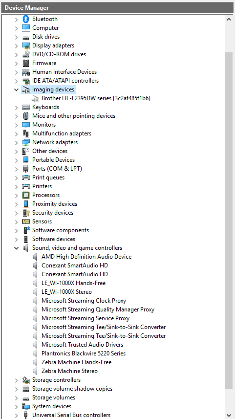

    Integrated Camera Does Not Show Up In Device Manager
    My internal webcam in my HP laptop has stopped being recognized. Performing a scan does not make it come back up. It started a few days ago when I was trying to use my camera in a Teams meeting and could not get it to work. Checking for a windows update did not change anything. After uninstalling the driver I scanned for hardware changes but my internal camera was gone from the list.
    After trying out the legacy and most up-to-date drivers from HPs website I contacted HP support.
    They updated my BIOS firmware and we tried installing the universal camera driver again, but to no avail.
    During this period I have restarted my computer several times. I am the administrator account for this computer and have had "Show Hidden Devices" checked the entire time. My internal webcam does not show up in Device Manager at all.
    Integrated Camera Does Not Show Up In Device Manager 747fe13d-679e-4073-bd44-4358c726540e?upload=true.png
