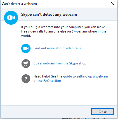

    I have a Dell Inspiron 15 5000 Series laptop running Windows 10. A few days ago, the built-in webcam stopped working completely. Programs like Skype, OBS, and TestWebCam all fail to detect it.

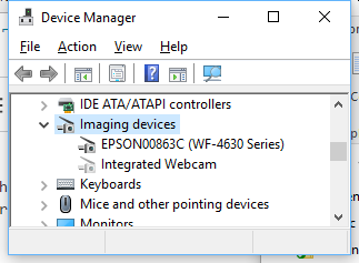

    At first, the camera appeared to be missing from Device Manager. However, after selecting View → Show hidden devices, I found my Integrated Webcam listed under Imaging Devices.

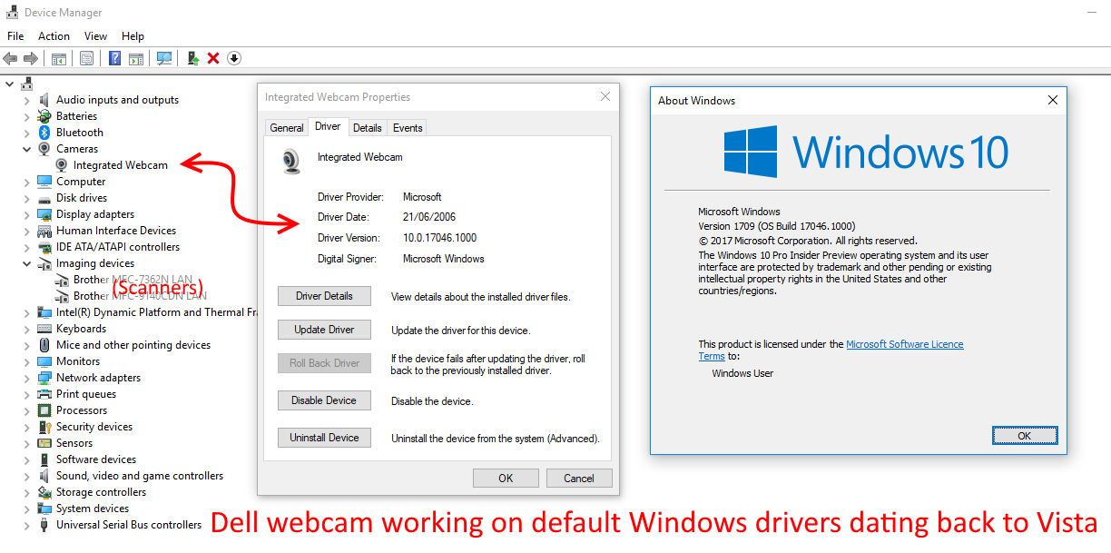

    First thing: Check BIOS
    F12 on boot... System Configuration > Miscellaneous Devices > Enable Camera.
    I have 35 of the the 13" ones. The commenters are correct that it is not normal for it to disable in device manager.
    I just got powershell to sweep the office DELL's:
    • 15 listed the webcam as "imaging device".
    • 20 listed as "Integrated Webcam".
    • none disabled.
    In fact, a quick visual shows that 4 users have a post-it stuck over it, so there maybe not be hardware/software key to disable it either... I usually re-format the DELLs to vanilla Windows 10 as soon as they hit my desk - all functions work... it will install as "Integrated Webcam" instead:
    Integrated Webcam No longer showing in Device Manager after Windows 10 Update YyOqR.png
    You have done most of the right steps to check/resolve so far but I will re-iterate them here
    1. Ensure winver is 1709
    There was an issue just before Windows 12-month anniversary update called "webcam-gate" that blocked many 3rd party webcams. This shouldn't affect you as you are using the generic imaging-device drivers... but it's a no brainer to do the latest Windows 10 update anyway. The Creator's Update (v1709) solves a few other issues with "Exclusive mode" (where 1 app takes control of a device and no others can see it) so ensure you are up-to-date first.
    2. Dell's PC diagnostics on boot (F12)
    After the first set of tests (~7 minutes) you can say "no" to additional RAM tests... and then be presented with a results screen. It will indicate if Webcam was skipped or tested. please confirm.

    4. (Software Option) eat fresh
    Uninstall it, (deleting the drivers) and try and get it to install usbvideo.inf_amd64_06d8dbf36a7321ac. This will make it pick up as a webcam, rather than imaging device. Failing that: Fresh install of Windows 10 by using the Windows 10 Media Creation Tool. The only thing from DELL you probably need is the DELL Update tool - and maybe DELL Software Delivery, if you want it to put that bloatware back on there (There are better free options, DELL just gets paid to shovel that onto your PC, which in turn keeps your purchase cost down... that's the only reason it's there). You don't need help+support. That is just a re-badged version of software called "PC-Doctor" and it allegedly causes issues with some PC-Security vendors (can provide sources if asked).
