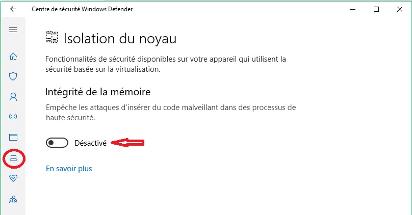

    intel 7 series/c216 chipset family usb enhanced host controller - 1e2d résolu
    Drivers " intel 7 series/c216 chipset family usb enhanced host controller - 1e2d " non reconnu
    Déactiver isolation du noyau pour résoudre le problème .
    intel 7 series/c216 chipset family usb enhanced host controller - 1e2d  résolu 917b679f-a4e0-453e-83bd-fbf6b6738c25?upload=true.jpg
    Hephays, Jul 8, 2020

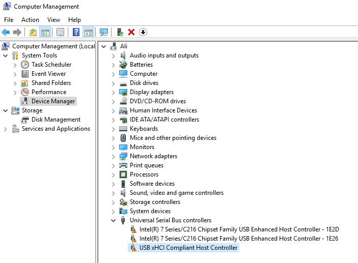

    1- I didn't do any changes..
    2- these are the issues of each device:
    • Intel(R) 7 Series/C216 Chipset Family USB Enhanced Host Controller - 1E2D:
      A driver (service) for this device has been disabled. An alternate driver may be providing this functionality. (Code 32)
    • Intel(R) 7 Series/C216 Chipset Family USB Enhanced Host Controller - 1E26:
    • USB xHCI Compliant Host Controller:
    3- I did the troubleshooter before and no thing happened...
    Thanks for your time...
    Ali Kniesh, Jul 8, 2020

    I have ASUS G75VW laptop...
    I've upgraded the windows from 8.1 to 10...
    the problem that these drivers couldn't worked:
    I've downloaded the intel driver tool didn't find any compatible devices...
    and I've downloaded intel chipset driver for windows 8.1 and didn't work...
    I've opened the exe setup by compatibility tool but it didn't worked...
    of coarse I deleted the driver and installed it again...
    and this is the picture can explain the problem...
    and thank you for your time...
    intel 7 series/c216 chipset family usb enhanced host controller - 1e2d  résolu 81091470-acf3-4ffe-816e-9f2d3cd1d8e4.jpg
