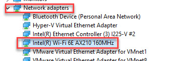

    2) Locate the WiFi Adapter in device manager:
    Intel wireless-AC 9560 160MHz driver not work 340097d1625873909t-intell-r-wireless-ac-9560-160mhz-cannot-start-code-10-a-image1.jpg
    NOTES: My WiFi adapter has a different name than yours because this particular machine has a different module installed.

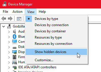

    If the device does not show up in Device Manager, try enabling the display of hidden devices like this:

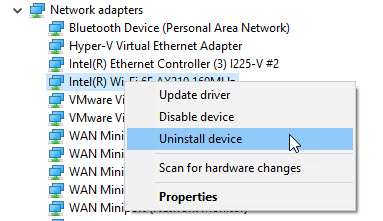

    3) Right-click and select the option to uninstall the device. Make sure to delete the driver as shown below.
    Intel wireless-AC 9560 160MHz driver not work 340099d1625874045t-intell-r-wireless-ac-9560-160mhz-cannot-start-code-10-a-image3.jpg
    Intel wireless-AC 9560 160MHz driver not work 340100d1625874093t-intell-r-wireless-ac-9560-160mhz-cannot-start-code-10-a-image4.jpg
    4) After uninstalling, install the two drivers you downloaded.
    5) You will need to rejoin your wireless network.
