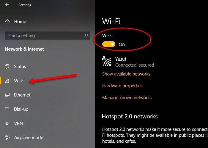

    2] Check your Settings
    An update can turn off some network devices on your computer. Therefore, we need to check your Settings.
    Enable Wi-Fi
    To check if your Wi-Fi is enabled, launch Settings from the Start Menu and click Network & Internet > Wi-Fi. Now, use the toggle to enable Wi-Fi.
    Note: If your WiFi is enabled and connected try disconnecting and then connecting to the Network.

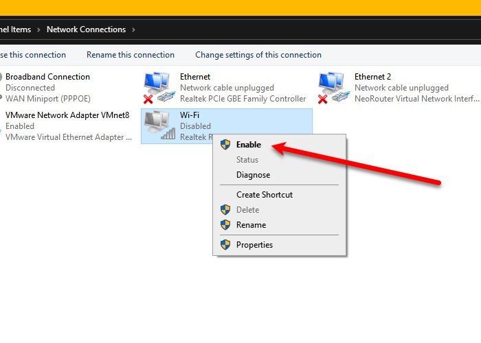

    Enable Network Adapter
    Probably the most common error one can face after an update is the disabled Network Adapter. So, let’s check if that’s your case. Launch Settings from the Start Menu and click Network & Internet > Status > Change adapter options. Right-click on your network adapter and select Enable (if it’s disabled).
    If these settings are fine, check later solutions.

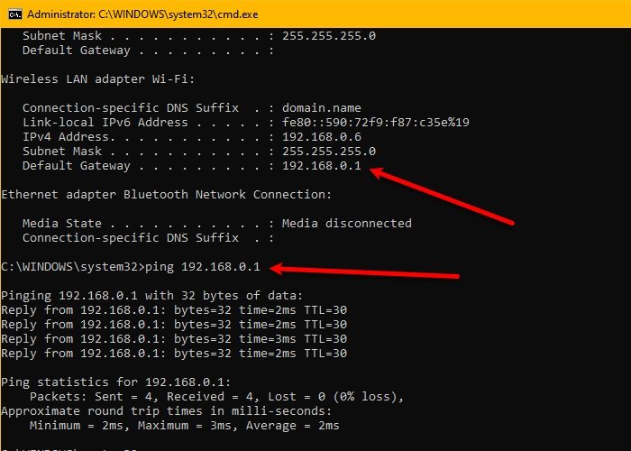

    3] Check if the Router is accessible
    We need to confirm that the problem is not because of your ISP but your Computer before moving forward.
    First, check your Default Gateway. To do that, launch Command Prompt as an administrator, type the following command and hit Enter.
    ipconfig
    Look for Default Gateway under “Wireless LAN adapter Wi-Fi” ( or Ethernet section if you use that). Once you know your Router’s Default Gateway, ping your Router. For that, type the following command in the Command Prompt and hit Enter.
    ping <Router’s Default Gateway>
    Examine the result you got. If all 4 sent packets are received, the connection between your System and Router is fine. You may have to contact your ISP to check if the connection between your Router and ISP is working.

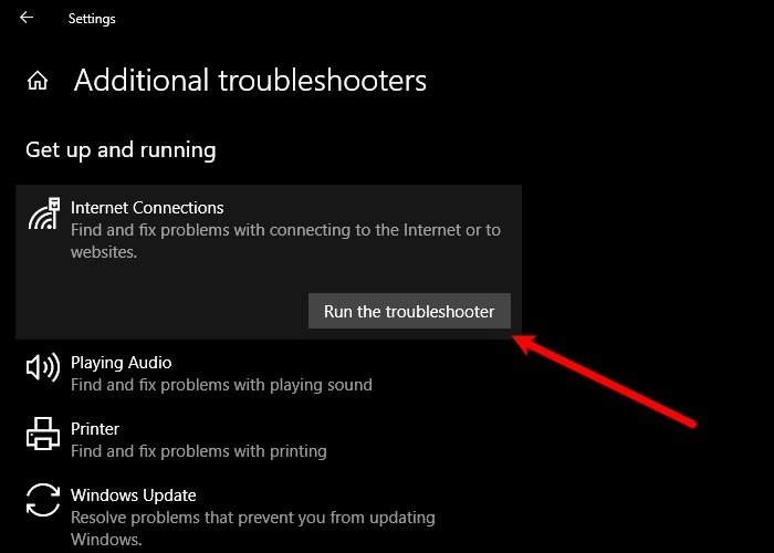

    5] Use Network Troubleshooting
    You can use Windows built-in Network Troubleshooter to fix the issue.
    To do that, Settings and click Update & Security > Troubleshooter > Additional troubleshooters > Internet Connection > Run the troubleshooter.
    Let it run and check if it can fix your issue.

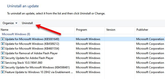

    7] Uninstall Updates
    If none of the mentioned solutions worked for you, try uninstalling recent updates. This self-explanatory, since, the problem was caused by an update, removing it will fix the issue.
    Uninstall Quality Updates
    To uninstall Quality Updates follow the following steps:
    1. Launch Settings by Win + X > Settings
    2. Click Update & Security > View update history > Uninstall updates.
    3. Select your last update and click Uninstall.
    After uninstalling the update, try restarting your computer and check if the issue is solved.

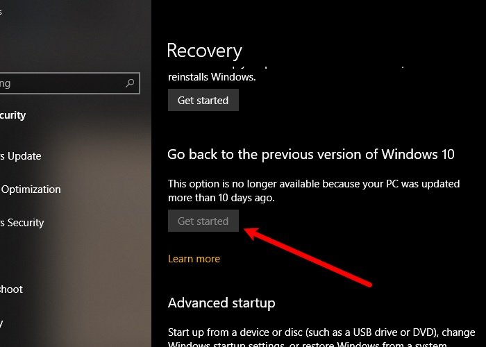

    Uninstall Feature Updates
    If you haven’t received a Quality update but a Feature update then you have to roll back to the previous version of Windows 10 to fix the issue. Make sure to make a full backup of your user files before proceeding.
    Follow the given steps to uninstall Feature Updates in Windows 10
    Launch Settings by Win + I
    Click Update & Security > Recovery > Get Started from the “Go back to the previous version of Windows 10” section.
    Afterward, follow the on-screen instructions to uninstall the Feature updates. Now, check if the issue persists.
