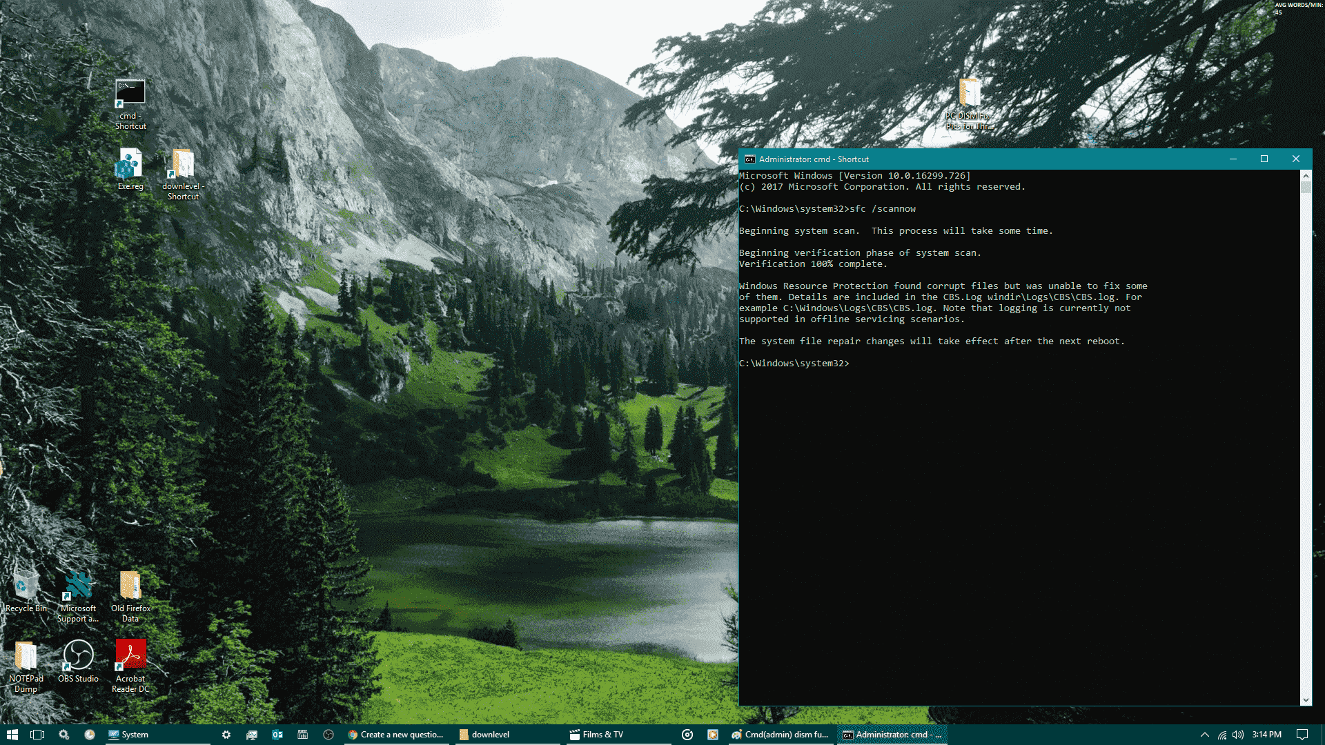

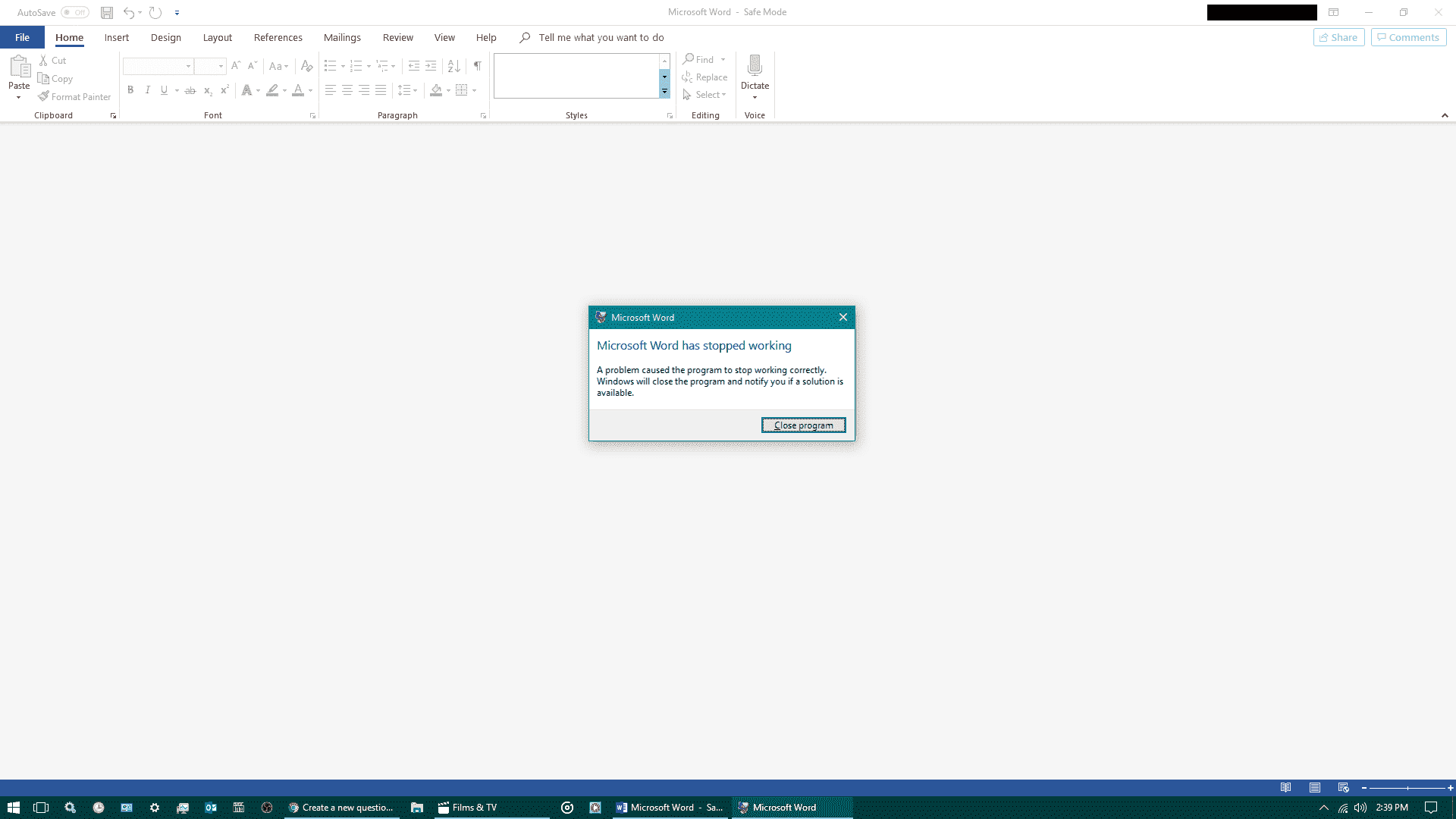

    Last Saturday (Nov 17th) I accidentally turned off my desktop tower by holding the power button rather than mousing over to 'Shut Down' in Start, and apparently that caused a .dll error the next boot-up on Sunday. I couldn't open any .exe files. (MSoft Office, Download setups/exes, including games)(Windows Update wouldn't complete, so my drivers are stuck). I can still download files from the internet, but I couldn't really use them. I can't install, uninstall programs. Metro apps work, Google Chrome works, Firefox, Edge, and IExplorer do not. This is what it shows for most of them after running(as admin of course):

    When I started troubleshooting, I found I had a corrupted .dll file after checking with through some cmd lines.

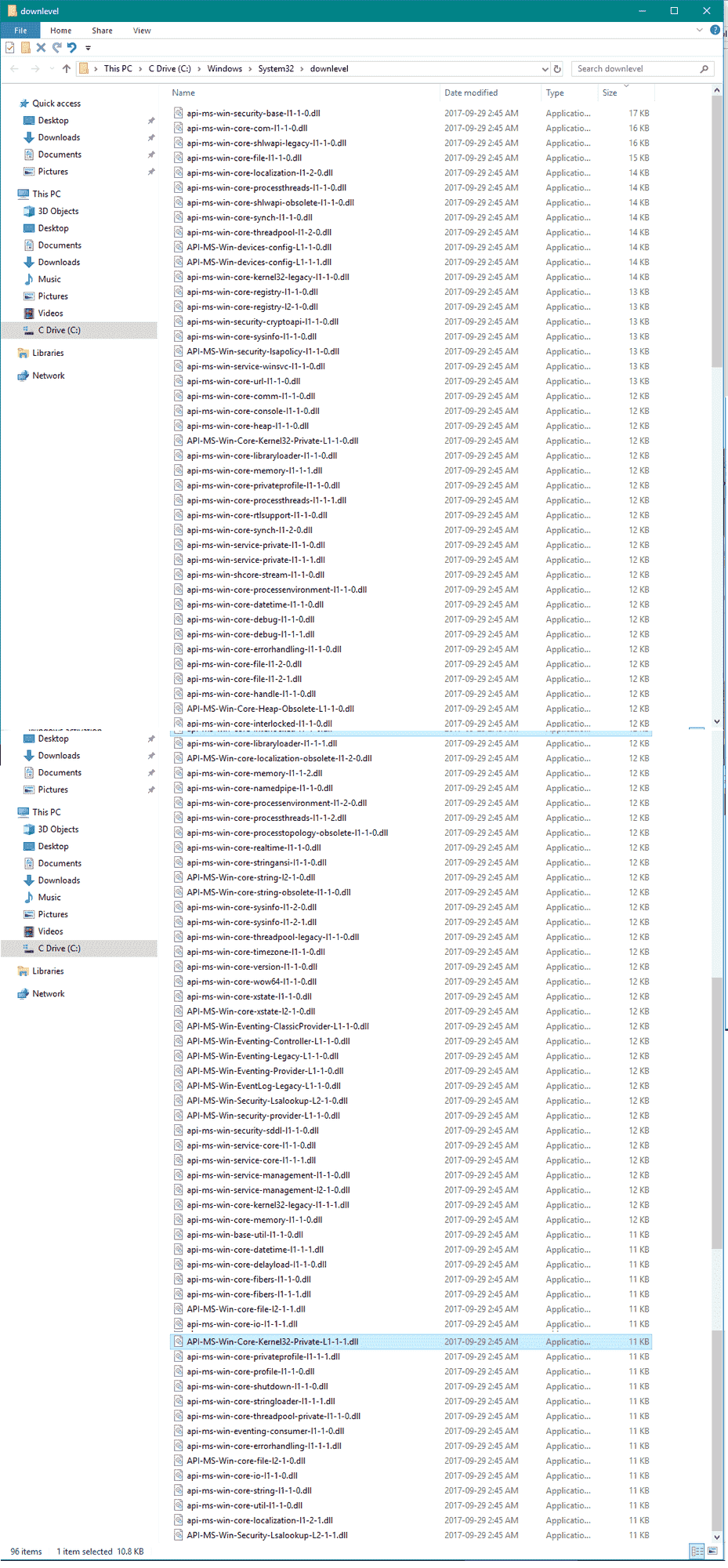

    -Go to C: > Windows > System32 > downlevel (apparently some users had incorrect files here causing sfc and dism scans to stop)(I don't know if I'm missing a .dll or if I have something I shouldn't have), (see my downlevel directory below, I edited the screenshots in Paint to show all the contents except personal data)

    • sfc /scannow (Didn't work)

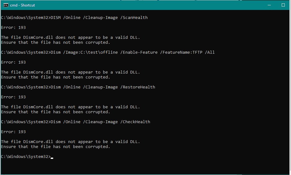

    • Dism /Online /Cleanup-Image /ScanHealth
    • Dism /Online /Cleanup-Image /CheckHealth
    • Dism /Online /Cleanup-Image /RestoreHealth
    • Dism /Image:C:\test\offline /Enable-Feature /FeatureName:TFTP /All
    ...the system said:
    Invalid DISM, Error 193, Can't open any .exe f461c556-cfcd-4929-99e4-6425e0738d4d?upload=true.png
    Invalid DISM, Error 193, Can't open any .exe 6d4d26f6-f229-4ad9-881d-67e50a1f9371?upload=true.png
    Invalid DISM, Error 193, Can't open any .exe 9986403f-7d2f-45c0-af6f-d947e7ba9e79?upload=true.png What I haven't tried:

    Thank you for the suggestion and clear explanation, but it doesn't work. As with the
    thread
    mentioned above
    DISM /Online /? already returns error 193
    Martijn vG, Nov 19, 2018
  3. Cybot Win User
    DISM error 193
    I tried that, I get dism error code 193 even when I try an offline repair
    adding any switches past the /online part, even the switch /?, results in error 193
    Cybot, Nov 19, 2018
  4. Cybot Win User
    DISM error 193
    I have discovered that when I type 'dism /?' the help options are displayed, but when I type 'dism /online /?' error 193 occurs.
    Cybot, Nov 19, 2018
