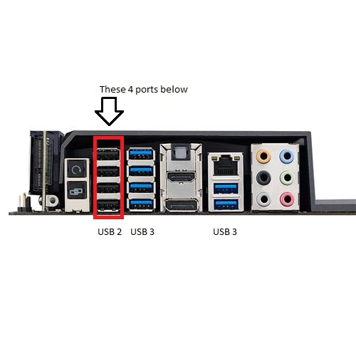

    Update KB4015438 broke all my USB 2 ports on my motherboard. USB 3 are fine.
    Hi all,
    I have windows 10 set up to defer updates and I noticed that there was a update that needed a restart. After the restart my mouse wasn't working I then realised that all the 4 black USB 2 ports on the back of my motherboard were not working any more. The
    6 blue USB 3 ports are fine thankfully.
    The update that caused the issue was the following;
    Cumulative Update for Windows 10 Version 1607 for x64-based Systems (KB4015438)
    iPhone and iPad don't update on USB 2 port update fine on USB 3 port 2c9dc1e7-40a4-4011-8328-ba8117c1b4a5.jpg
    I checked my Motherboard BIOS and all the ports are enabled as normal.

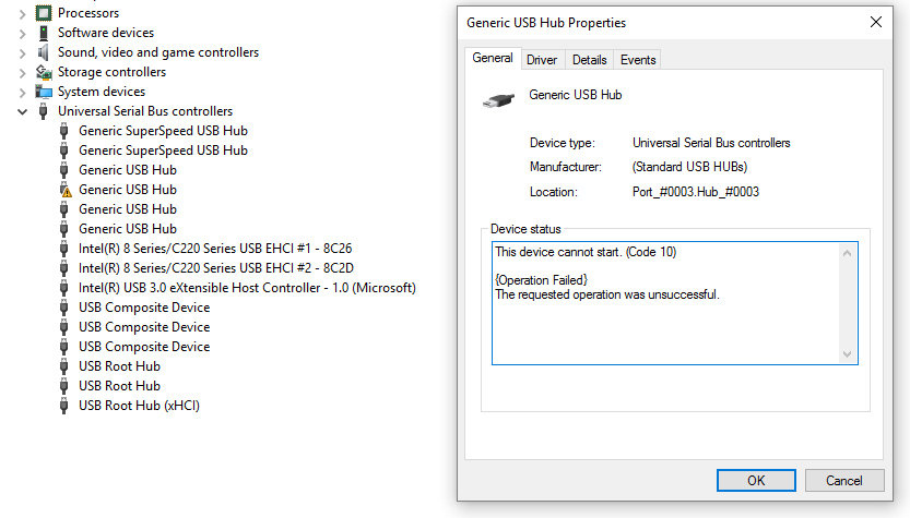

    Looking in Device Manager I got the following error.
    iPhone and iPad don't update on USB 2 port update fine on USB 3 port ee604d54-9de6-40df-9dbe-c475293dbfec.jpg
    I tried updating the driver but that didn't help and also uninstalled and reinstalled the driver sadly that didn't help either.
