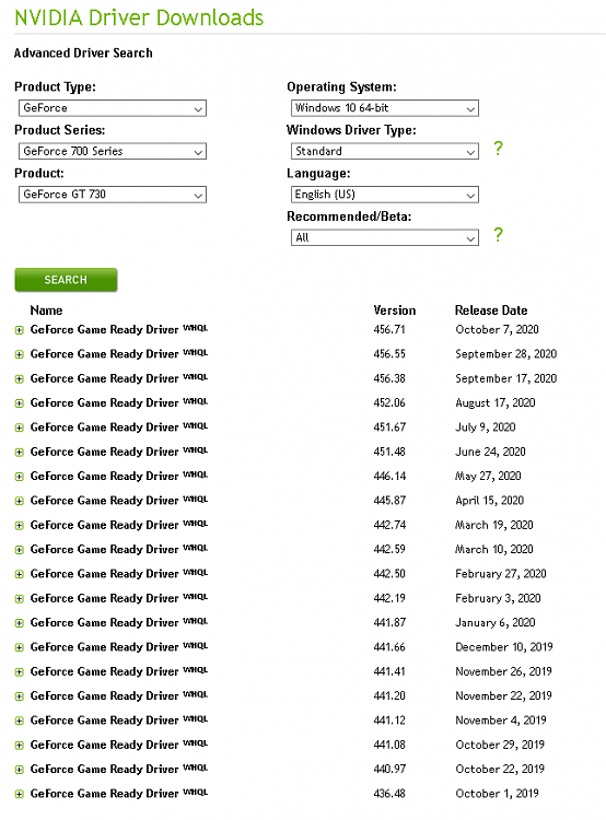

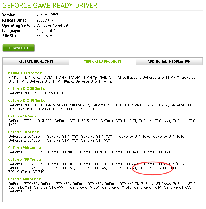

  3. bobkn Win User
    Can't install Latest Nvidia Driver
    I didn't mention that nVidia's driver search offers 456.71 for the GT730, as you post. I checked that first.
    I also checked the supported devices list.
    I recognize the inconsistency. That's why I qualified my post. I can't recall a specific example, but I'm fairly sure that the nVidia servers have offered drivers in the past that were no longer supported on old cards. I have no direct knowledge whether that may be true here.
    I'm unsure as to what drivers Windows Update provides for newer cards. I imagine they're newer than 388.13. That strongly suggests that the GT730 is not supported by recent drivers.
    I suggest that "bug67" try the older drivers. If those work, that would suggest that there is no hardware issue.
    If "bug67" wants the latest drivers, but the GT730 isn't supported, it may be possible to modify the installer to accept it. (Need a hobby?)
    bobkn, Mar 6, 2025
