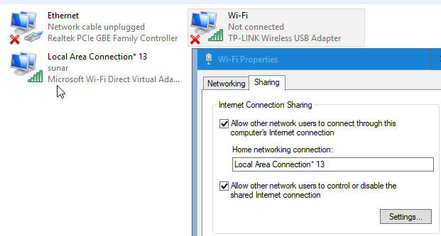

    Next,
    I turn off the mobile hotspot on my phone and in my computer, the Network Connection of the Wi-Fi icon now has a red cross mark, just like when I create "Hosted Network" manually :
    Is "Mobile Hotspot" feature the same with manually create "Hosted Network" ? 4e97bb74-fae2-4d43-8196-267333168c1d?upload=true.png
    then on the phone I enable the wifi and choose to connect to "Computer" with password "12345678".
    But on my phone it never connected to the computer's hotspot as it stuck on "Obtaining IP address.....".
    I wonder if it actually should work because creating Hosted Network manually is just the same with turning on the Mobile Hotspot feature via "cheating" or it actually won't work because although via "cheating" the Mobile Hotspot looks like the same with creating the "Hosted Network" manually - but it's not the same.
