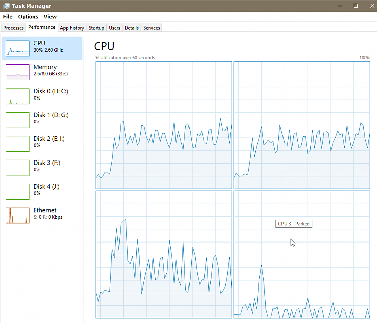

  4. Edwin Win User
    Is QuickCPU safe if you are just using it to change the performance plan on Laptop?
    Is it safe to change CPU core setting in msconfig on HP laptop?
    Not sure what you want to change but, you shouldn't have to change anything in msconfig;
    if you set 'High Performance' power plan, no cores will be 'Parked', other plans will intermittently park cores limiting performance.
    Balanced Power Plan:
    Is QuickCPU safe if you are just using it to change the performance plan on Laptop? 103051d1485972245t-safe-change-cpu-core-setting-msconfig-hp-laptop-000007.png
    Edwin, Feb 26, 2023
