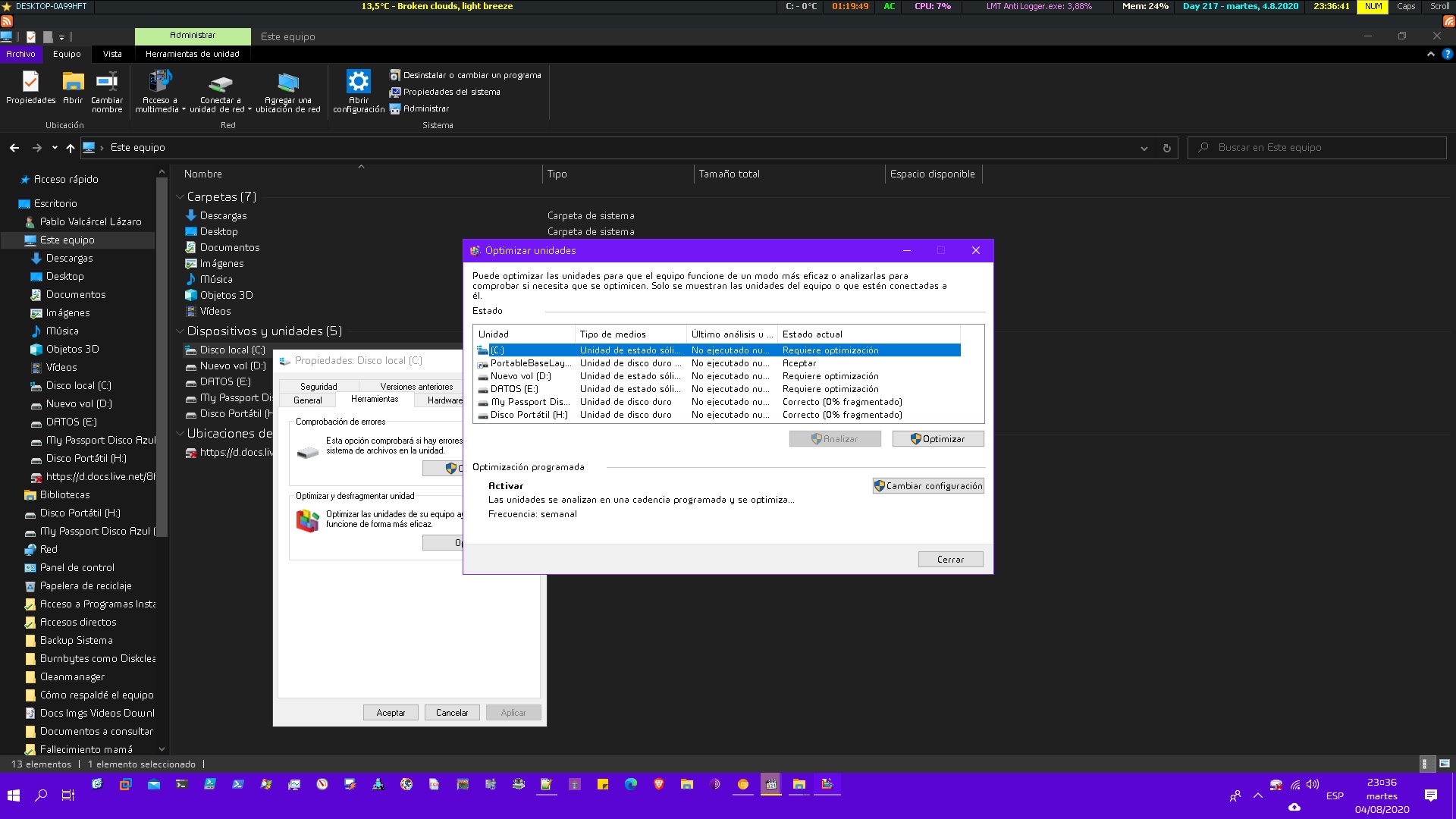

    Hello all.
    According to this article it says that windows 10 performs monthly SSD defragmentation. I would like to ask if it's the same than optimization feature you have when you right click on ssd -> Properties -> Tools -> Optimize and from there you can select each SSD you have to optimize. Is that the same that defragment ssd or are completely different things?
    Is the same SSD optimization than SSD defragmentation? 731e6ba8-2853-487b-959d-50b201fe36cb?upload=true.jpg
    Thanks in advance for your help!!!

    SSD Optimization
    Hi Jack
    Microsoft don't recommend optimizing an SSD only HDD's, it is just they have not removed SSD's form the optimize list . . .
    With regards to TRIM, you will not find that in a search, because it is not an application, it is a function of Windows that is turned on automatically, once Windows detects an SSD
    Click your Start Button, then just type cmd and hit Enter
    Paste this into Command prompt and hit Enter
    fsutil behavior query DisableDeleteNotify
    Does that command return a 0 i
    I so, trim is turned on and you are good to go . .
    DaveM121, Aug 4, 2020
