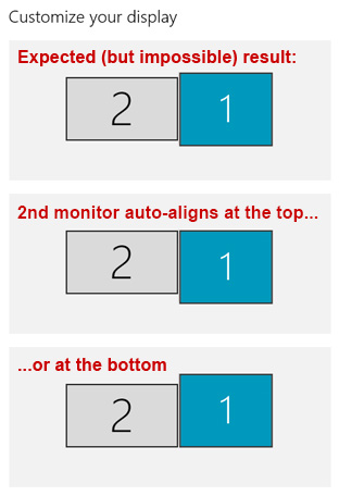

  3. Fine-tune the position of multiple displays relative to each other
    Maybe this image helps illustrate the problem:
    is there a way to fine tune the position of multiple monitors when one is landscape and the... 0f0775f7-3d2b-4994-ae00-f5b99d5a4878.jpg
    This is the monitor alignment that can be reached via right-click on desktop --> "Display Settings". When one display is dragged too close to the upper or lower end of the other, it automatically aligns to the top or bottom of the other display. Sadly, this
    means that when the vertical resolutions are very similar, a centered alignment becomes impossible. It always snaps into place as shown above.
    When the vertical resolutions are different enough, such as 1920 x 1080 and 1440 x 768, this is not an issue. I've tested this with an older monitor. But the ones that I ultimately want to use have native resolutions of 1920 x 1080 and 1600 x 1200, and that's
    too similar for a centered alignment. There ought to be a way to disable the automatic alignment or maybe fine-tune the position via the cursor keys.
    Tastentier, Oct 3, 2019
