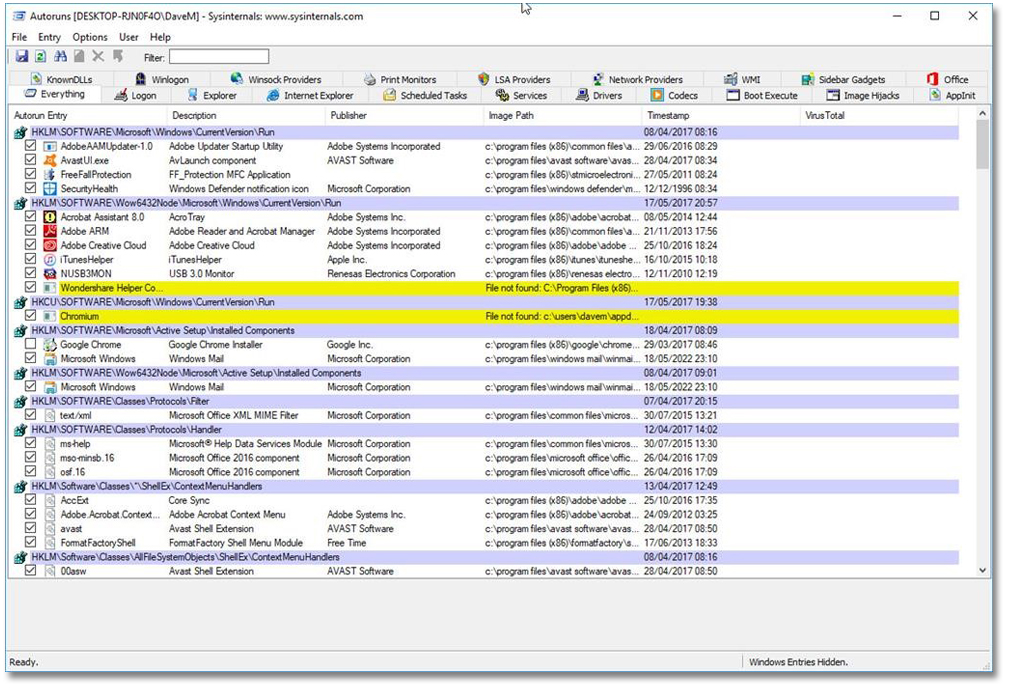

  2. DaveM121 Win User
    Google Chrome Opens on Startup
    Definitely something on your system startup is causing Chrome to open up
    The Startup tab on Task Manager and msconfig offer limited options for stopping Startup Processes
    Click HERE to download Autoruns from Technet, a small
    free utility that does not need installing. This utility will give you a much more detailed view of apps and processes starting with your system . . .
    • Unzip the Download, right click either Autoruns.exe or Autoruns64.exe (depending on whether you are running 32bit or 64bit Window 10) and select 'Run as Administrator'
    • Scroll down to find any entry referring to MSN or Chrome (ignore updaters) and uncheck it
    • Restart your system and this annoyance should be gone
    Is there a way to stop Chrome from opening on startup without unchecking "open where you... 8087e3cb-8975-4288-bd7c-b42700859787.jpg
    DaveM121, May 4, 2019
  3. JudyKane Win User
    This sounds promising. I was referred to this solution from my own chain about my problem of getting Chrome to stop autostarting since the lastest Windows 10 update (about a month ago).. I wasn't clear about whether to uncheck something based on the above.
    Chrome was listed in several places, but not start. I don't want to click on something that will make things worse, and I wasn't clear about whether going to properties for any of these entries was part of the solution.
    Chrome is checked on the Everything tab for HKCU\SOFTWARE\Microsoft\Windows\CurrentVersion\Run and for HKLM\SOFTWARE\Microsoft\Active Setuo\Installed Components
    It is not listed for
    ProgramData\Microsoft\Windows\Start Menu\Programs\Startup
    I don't see a category for autostart.
    I also didn't see Chrome listed on any other tabs.
    JudyKane, May 4, 2019
