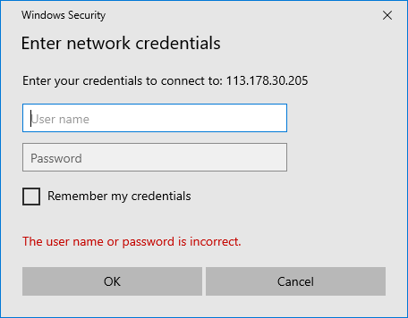

  4. Issue with SMB Shares W10 Client and Server
    SMB file servers keep asking for credentials
    I have both Windows 10 SMB and Linux Samba file servers. The share permissions are:
    • browsable (Linux) / turn on file and printer sharing (Windows)
    • guest ok (Linux) / turn off password protected sharing (Windows)
    • Appropriate file system level permissions on both servers (not really matters here)
    Most of the time, using a Windows 10 client to connect to the shared folder is straight forward, just \\my-server and
    it is fine. But sometimes, it keep asking for credentials for unknown reason.
    Issue with SMB Shares W10 Client and Server 83de1903-dd22-4fab-b664-a2570faccf3d?upload=true.png
    It won't connect if I leave all fields blank. Sometimes I need to type a random user account with a blank password, and sometimes both a random account plus a random password to pass that stupid prompt. Linux
    clients do not suffer from that issue, at least by using smb://my-server on Ubuntu's Nautilus and select Connect anonymously.
    To make the problem worse, let's say I have a shared printer on the server. After a client provides a random user + password, he can connect to the server and use the shared printer. After a few days, he suddenly
    cannot print using the previously added printer, until he tries to connect and provides a random user + password again (the printer does not need to be re-added). Looks like the junk user + password time out after a few days (even if you do check Remember
    my credentials
    The issue occurs randomly. What could be the cause of the problem?
    Livy Inverse, Feb 10, 2020
