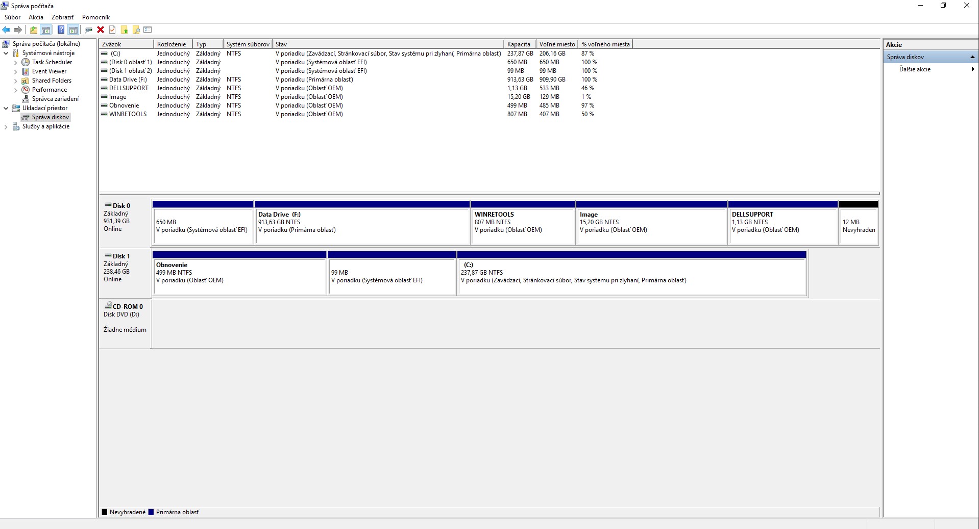

  2. Issue with a new SSD and Windows Boot manager
    Recently I did install a new SSD into my Aurora R7. I've unplugged my HDD, installed the SSD, used Windows on an USB and installed the Windows on the SSD. Then formatted the HDD. It works fine and my computer boots in seconds but if I go to BIOS and try
    to change the boot order the only thing showing there is Windows Boot Manager and some other 2 options which I can specify if needed. There is no sign of the SSD. Thanks for help!

    A UEFI system boots to a Windows Boot Manager, not a drive. On your attachment, you are booted into the smaller drive.
    There may be an expanded description which would identify the SSD.

    Hi Matej
    If you have UEFI BIOS you will not see your drives listed in the Boot preferences, you will have Secure Boot, the only way to see the drives on your system would be to swap to Legacy BIOS - please don't do that!
    Are you having a problem booting your system from that SSD or is there another reason you need to change the boot order . . .
