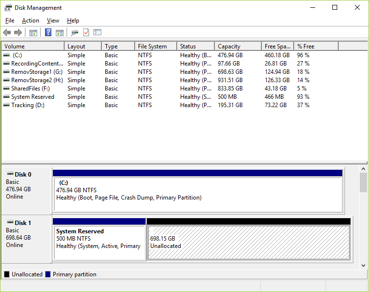

  2. System Reserved Partition on Disk 1 not Disk 0
    The results were the same as before: Windows is installed in a single 477 GB partition on Disk 0 and the System Reserved is in a 500 MB partition on Drive 1. The rest of Drive 1 is unallocated. This is identical to the configuration I had when I asked the
    question.
    The Media Creation Tool used to created the install ISO DVD is v. 10.0.14393 downloaded on 12/13/2016.
    I followed your instructions:
    • I selected Drive 0 and deleted the existing Windows partition.
    • I clicked New and Apply. Windows then formatted Drive 0 as a single primary partition.
    • The existing System Reserved partition was still on Drive 1.
    • So I deleted the System Reserved partition on Drive 1 and the just created Primary partition on Drive 0
    • I then selected Drive 0 and clicked New and Apply again. Same result a single Primary partition on Drive 0. Drive 1 was left unallocated.
    • Upon completion of the install
      • Windows occupies about 15 GB in the only partition on Drive 0
      • The 500 MB System Reserved partition was placed on Drive 1
      • The rest of Drive 1 is unallocated.
    How can I get the System Reserved partition to be placed as the Partition 1 on Drive 0 with Windows installed in Partition 2?
    Thanks.
    Bill
    B_Phillips, Nov 9, 2024

  4. It will not let me download and install update for ASUStek computer inc. system 1.1.0.0...
    I apologize for my poor communications skills. I followed the steps you'd recommended and show, but for me the System Reserved partition is being placed on Drive 1 not Drive 0. Do you know how I can get the results you got, with the System Reserved in Partition
    1 and Partition 2 marked Primary and both on Drive 0?
    Keep in mind, as I tried to explain in my question and 1st reply, that there's an existing System Reserved partition on Drive 1 when I enter the "Where do you want to install Windows" screen. What can I do to achieve that?
    I first tried to follow the steps you had described and show above, but only one partition marked Primary was placed on Drive 0. So I then deleted everything including the existing System Reserved partition on Drive 1 and deleted the Primary partition just
    created on Drive 0.
    That left Drives 0 & 1 as all unallocated space, I then selected Drive 0 again, clicked New and Apply. Still what was returned was a single Primary partition on Drive 0. Drive 1 was still unallocated, but the install result, as shown below, has the System
    Reserved partition on Drive 1.
    I can't understand why I'm getting results different than you're getting. In the past I've got the expected (both partitions on Drive 0) result on this same computer, but for some reason, I'm not getting them now.
    This PC does have 6 drives and drive 0 is an SSD, but I haven't had this problem in previous clean installs.
    Thanks for your patience.
    Bill
    It will not let me download and install update for ASUStek computer inc. system 1.1.0.0... 07d436fc-4dfb-43ea-8e43-5d2f9492338e.png
