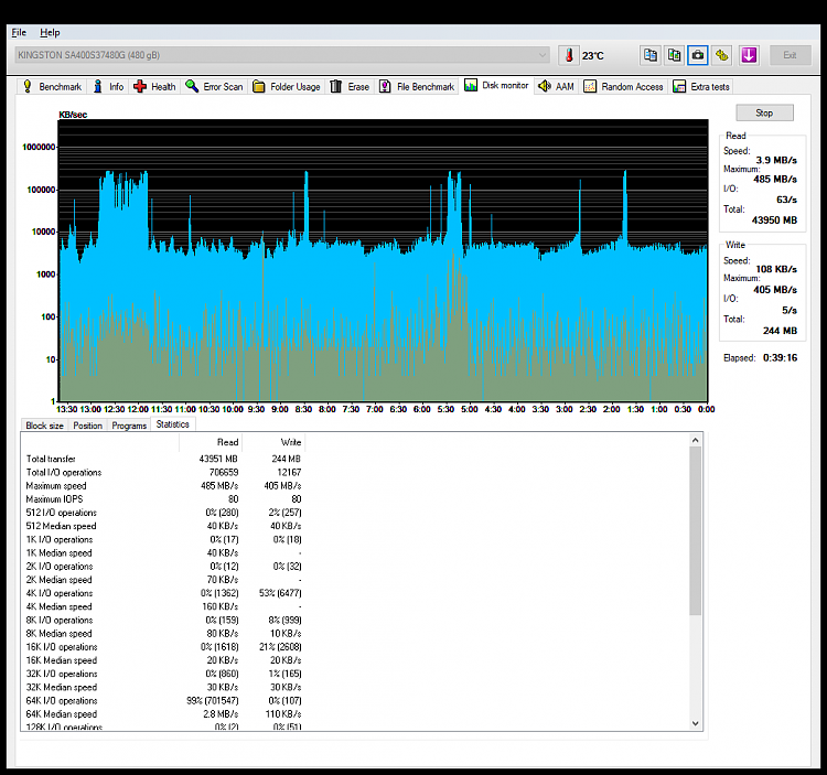

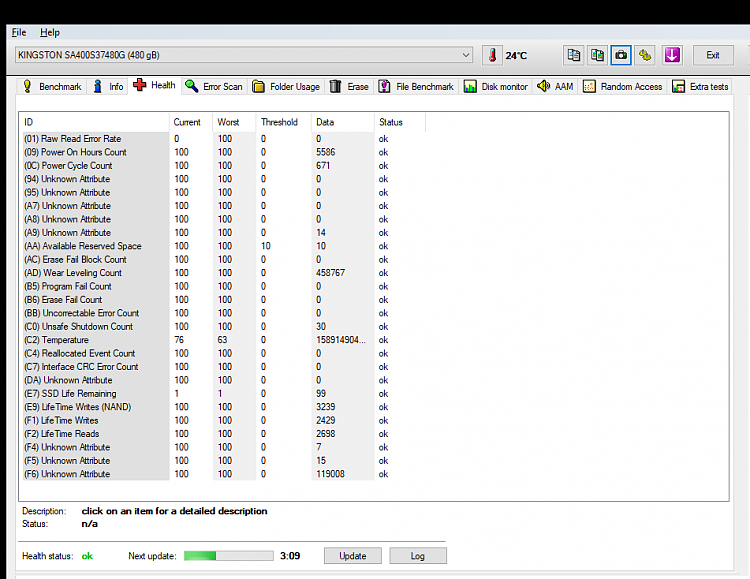

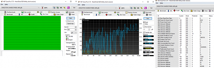

    UNEXPECTED_STORE_EXCEPTION at random, everyday, for the past 3 months
    Hello philc43 and thank you for your reply. Upon viewing both the programs you suggested, I don't know which are the actual tests I need to do, nor which screenshots you want in particular. That's why I tried pretty much everything that didn't seem risky, lol. Please let me know if you need anything else; thanks again.
    Seatools:
    - Short Generic resulted in a "Pass" (both SSDs).
    - Short Drive Self Test resulted in a "Pass" (both SSDs).
    - SMART resulted in a "Pass" (both SSDs).
    HD Tune Pro:
    - Error Scan for both SSDs resulted in green squares
    - Health status is "ok" for both SSDs
    - KINGSTON SA400S37480G Benchmark (First SSD)
    Test capacity: full
    Transfer Rate Minimum : 3.4 MB/s
    Transfer Rate Maximum : 100.1 MB/s
    Transfer Rate Average : 29.7 MB/s
    Access Time : 0.964 ms
    Burst Rate : 72.7 MB/s
    CPU Usage : 3.8%
    - KINGSTON SA400S37480G Benchmark (Second SSD)
    Test capacity: full
    Transfer Rate Minimum : 5.4 MB/s
    Transfer Rate Maximum : 402.5 MB/s
    Transfer Rate Average : 231.0 MB/s
    Access Time : 0.206 ms
    Burst Rate : 64.3 MB/s
    CPU Usage : 2.7%
    Windows Memory Diagnostic:
    - No errors found
    CrystalDiskInfo:
    - Health is "Good" for both SSDs
    Screenshots:
    I've had countless BSOD for the past 3 months and I need help determining whats wrong. 327658d1618489293t-unexpected_store_exception-random-everyday-past-3-months-1.png
    I've had countless BSOD for the past 3 months and I need help determining whats wrong. 327659d1618489293t-unexpected_store_exception-random-everyday-past-3-months-2.png
    I've had countless BSOD for the past 3 months and I need help determining whats wrong. 327660d1618494957t-unexpected_store_exception-random-everyday-past-3-months-3.png
    Memox, Mar 27, 2023

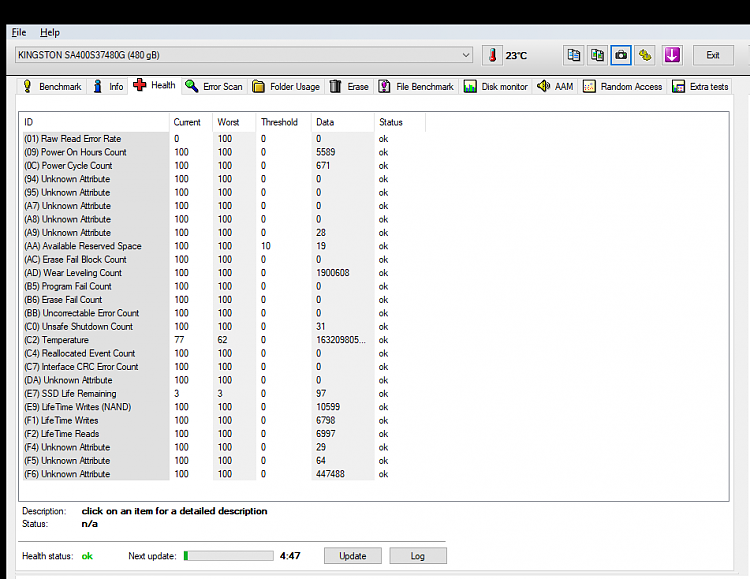

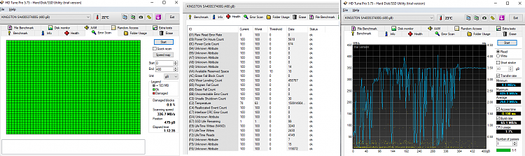

  3. Memox Win User
    I've had countless BSOD for the past 3 months and I need help determining whats wrong. 328361d1618834834t-unexpected_store_exception-random-everyday-past-3-months-1.png
    I've had countless BSOD for the past 3 months and I need help determining whats wrong. 328362d1618834834t-unexpected_store_exception-random-everyday-past-3-months-2.png
    And this is HD Tune. Sorry for the delay, I have a few busy days ahead so I'll upload the memtest ASAP. However, I have two things I want to mention in the meantime. First of all, I didn't have any BSODs in the past few days and the only thing I've changed was to move the keyboard from a USB port to another. Second of all, there was a technician who mentioned the following errors:
    Code:
    Why would my system reference a device that does not exist? Upon closer inspection, we found out this driver:
    Code:
    I know that DT can cause BSODs, especially when the system tries to reference a virtual disk when it has been removed... However, I've uninstalled DT way before the BSODs started. Is there a way to remove this driver too?
    Sorry for derailing your suggestions, I'll try to go back on-topic when I have the memtest logs/images. Have a good day.
    Memox, Mar 27, 2023
