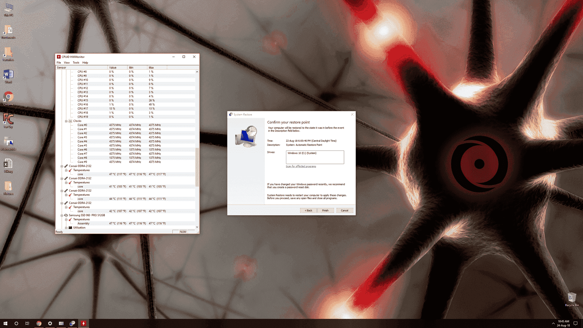

    problems with Spectre update KB4100347
    So Windows Update downloaded the Spectre patch, KB4100347, earlier this week -- and it seriously screwed up my processor speeds. I've got an i7-6950, overclocked to 4250 on the front five cores and 4375 on the back five -- the first screenshot attached
    shows the proper reading in HWMonitor.
    KB4100347 [​IMG]
    After the patch, even though the overclocking settings in my BIOS haven't changed, everything's screwed up -- all the cores are clocked to 4375, except random ones (it changes depending on reboot) that are massively downgraded. In addition, the update breaks
    Intel Turbo Boost Max, which does not boot, shows up as not installed in the device manager, and which will not reinstall or start (there's an error message saying there's a problem and a BIOS setting might need to be changed.
    So I know an update like this is needed because of Spectre; but I also know that my processor number is not actually among those listed in
    the knowledge base article
    . So is Windows downloading this update incorrectly? Is there another one that will actually work correctly with my processor? Is there something I have to do in the BIOS before I install this update? That's a problem because
    Asus still hasn't released anything but a beta BIOS for my board. I currently have my computer rolled back and KB4100347 blocked, but that seems like a temporary fix given the serious nature of Spectre. Any advice would be welcome.
    MJF74, Sep 9, 2018
