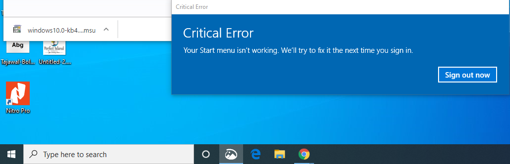

  4. jofii2009 Win User
    KB4515384 completely breaks my system
    Windows 10 KB4515384 is breaking down core features
    “Your Start menu isn’t working. We’ll try to fix it the next time you sign in,” a message titled ‘Critical error’ reads, and it includes a link to sign out.
    “I tried install KB4515384 on one of my workstation with no luck. Menu start stopped working with critical error and sign out demand. After uninstall latest CU problem with start menu was solved but action
    center won’t open now. Reinstalling update do nothing. Windows 10 especially 1903 is the most bugged OS ever. I suggest stay at 18362.295 as long as possible or until all flaws will be finally fixed,” a user noted.Again, a small number of users are experiencing
    this problem.A few users are also reporting problems with Action Center and external
    USB devices
    such as the keyboard.
    even safe mood not fixing it
    what i can do ?
    KB4515384 completely breaks my system 835deb48-b00d-4579-9492-796d8c05e1f4?upload=true.png
    jofii2009, Sep 15, 2019
