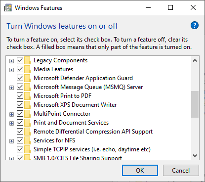

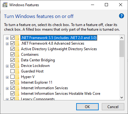

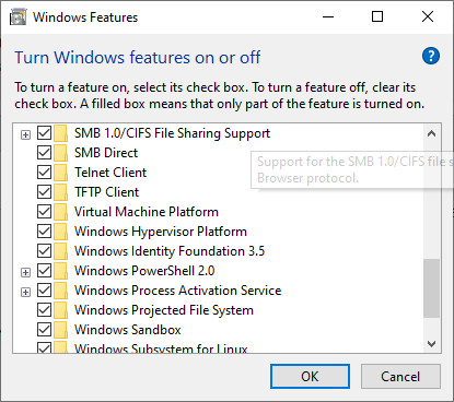

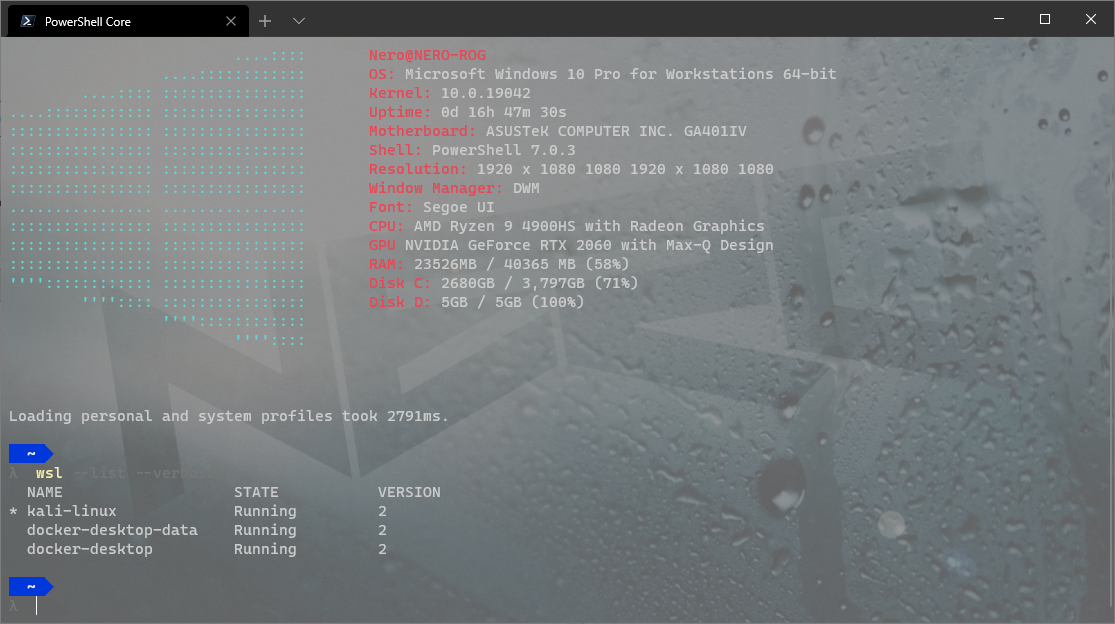

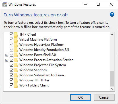

    These Windows features were installed:
    KB4586781 Failed to install on ‎11/‎12/‎2020 - 0x8007000d fab6d473-b8ea-4374-bda1-87872bfe145a?upload=true.png
    KB4586781 Failed to install on ‎11/‎12/‎2020 - 0x8007000d 9a05a4cc-1b84-4036-9df8-985cb64bbf27?upload=true.png
    KB4586781 Failed to install on ‎11/‎12/‎2020 - 0x8007000d 25b2279b-a91f-4ce7-b833-f5846f4774de?upload=true.png
    KB4586781 Failed to install on ‎11/‎12/‎2020 - 0x8007000d ec711aaf-061c-4310-9c45-851fa3abae72?upload=true.png
