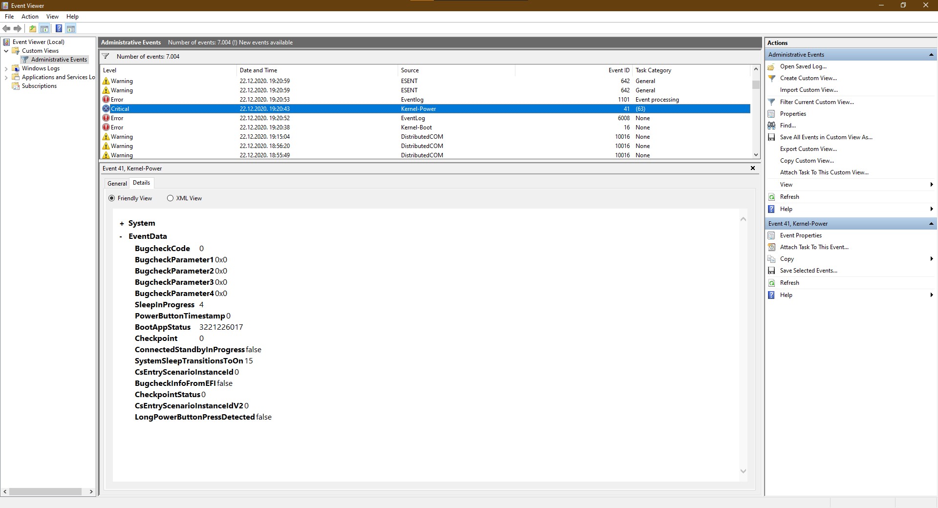

    Few years ago my pc started crashing. Then i had windows 7. I changed my power supply and it was still crashing. 1 and half year ago i buyed new gpu and cpu but it's still crashing. I have 10 year old pc and it's maybe time to buy new pc but i dont have money for one rn. In the event viewer when my pc crashes it logs this error and then it logs kernel-power and then another error:
    This happens a lot to me almost everyday but in every log it's diferent. Almost every log has zeros in everything but SystemSleepTransitionsToOn. In this one it's zero. In other it's 3. Every log has different number but all of them is 0,1,3 and 5. I think it's cause i click restart button so Windows doesn't have enough time to write everything. Sometimes i get BSOD and sometimes my screen just freezes so i need to restart my pc myself. When i get BSOD it restarts quickly so it's hard to see error but now i disabled auto restart. In one log that was kernel power i found this:

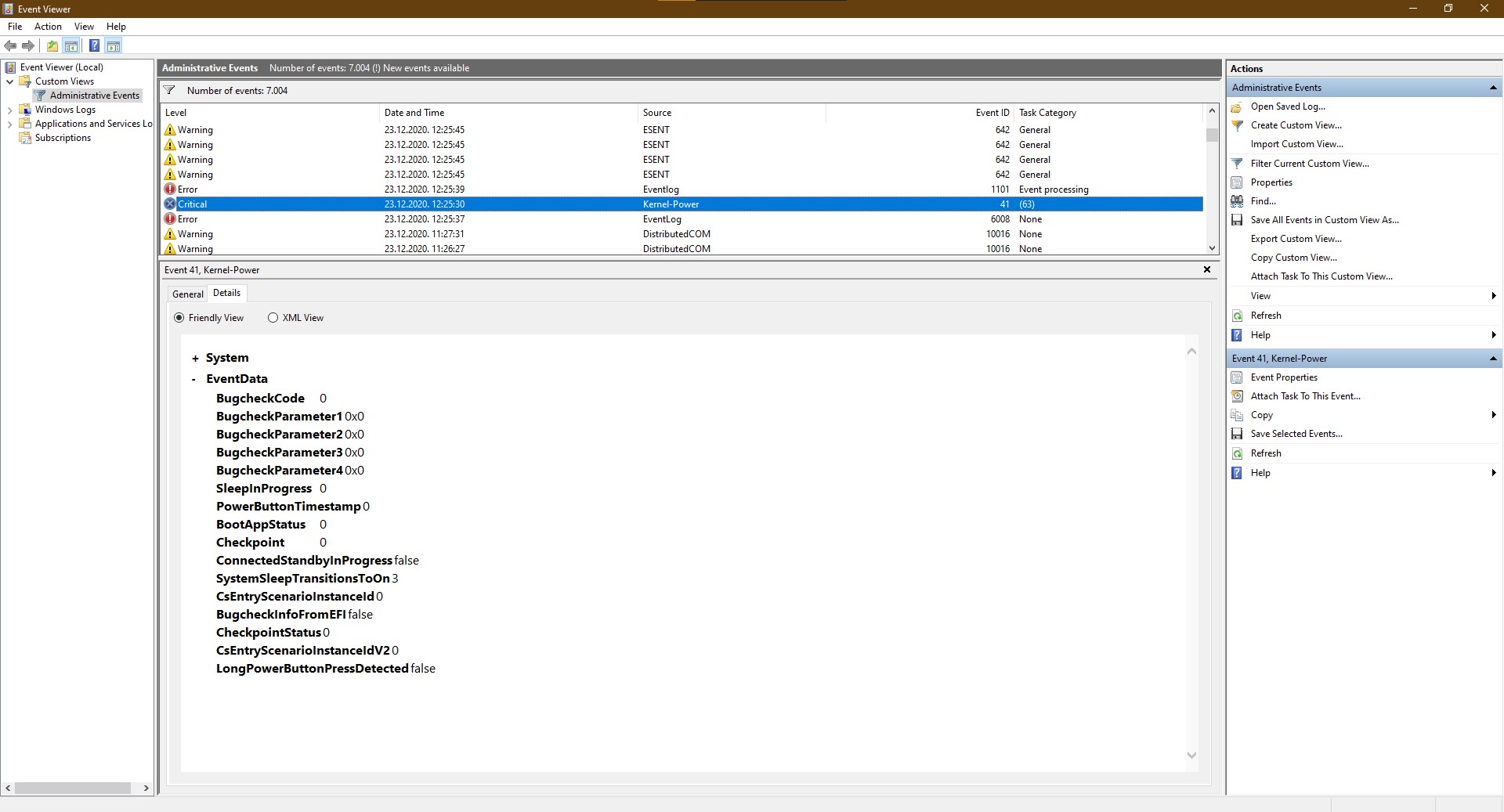

    Kernel power 41 f0bacb14-1435-4be9-9a8b-d95f36b7084b?upload=true.jpg That time i put my pc on sleep but it didnt go to sleep it was just turned on like fans were spining, my led on my gpu was turned on and that also happens sometimes to me so i need to turn off pc on power supply or sometimes it works when i click restart button. I also found now that at SystemSleepTransitionsToOn it has 17 but everything other is 0. Now i also found that some kernel-powers have error with event id 6008 before kernel-power log but after kernel-power there isn't any error but event id 6008 is before all kernel-power logs.
