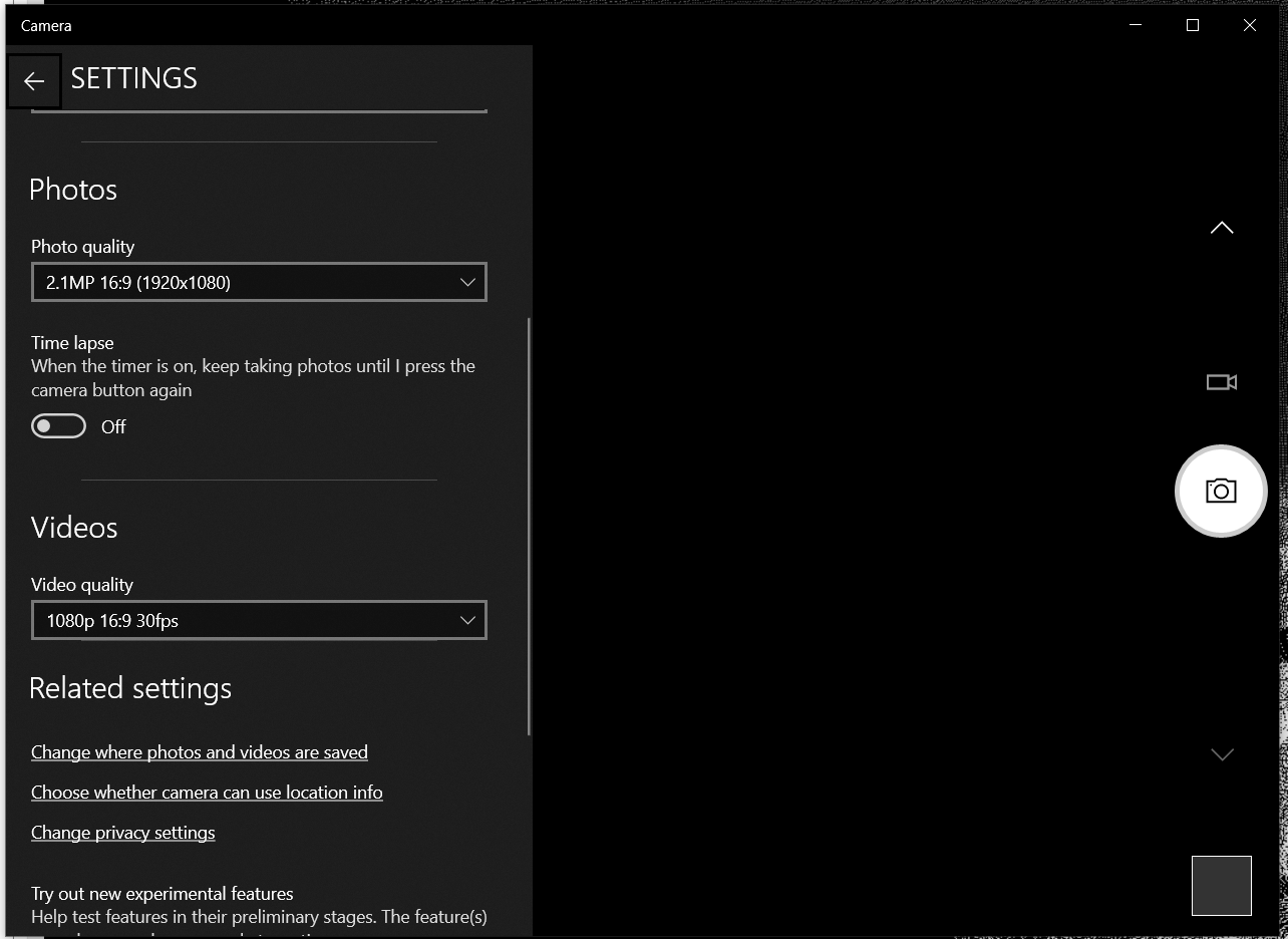

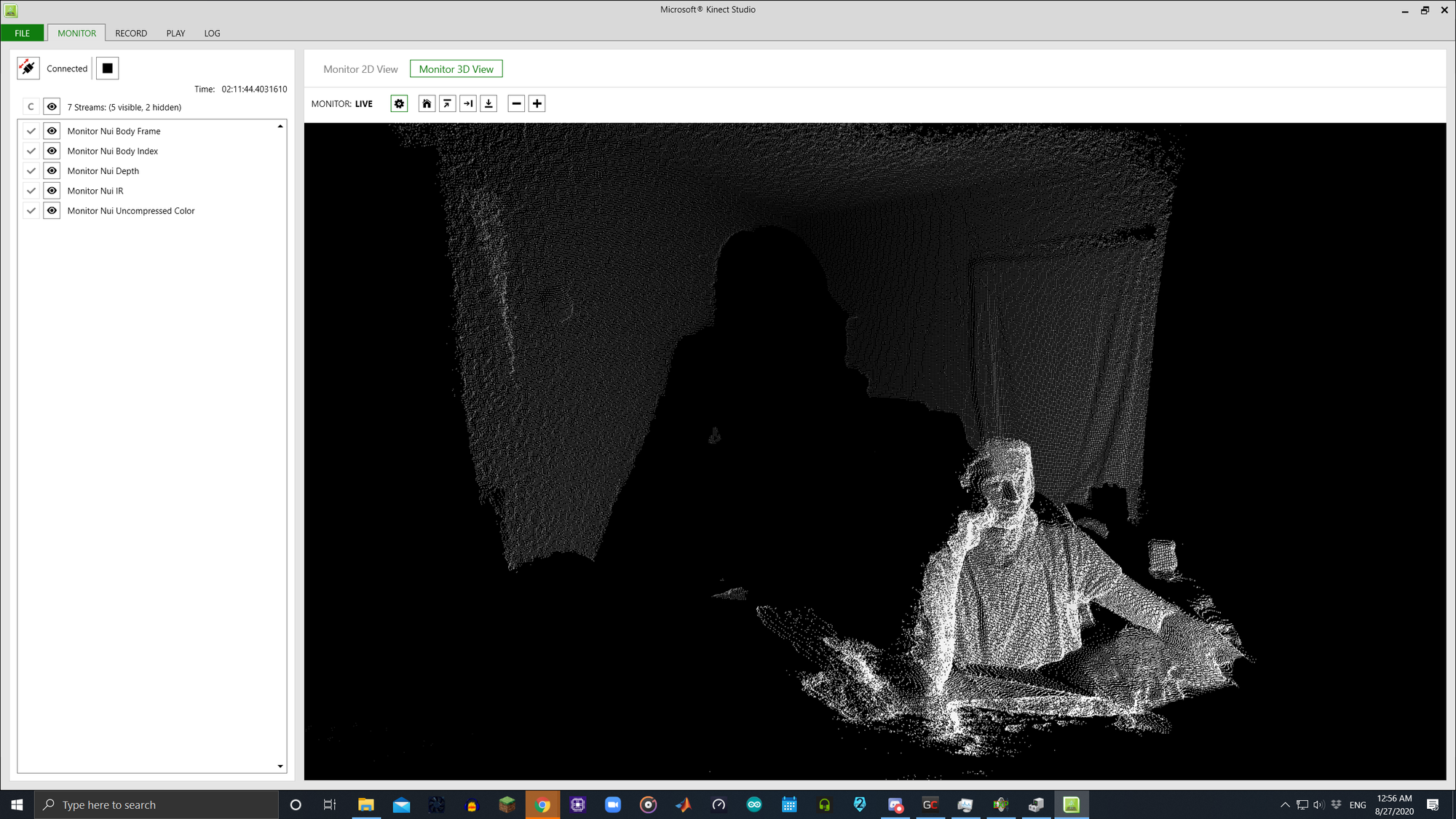

    With all the distance learning stuff, i figured my old kinect would work great as a 1080p webcam for Zoom sessions. Issue is, it refuses to send any kind of visual data to apps beyond the applications included in the kinect SDK.
    Now, it is manually modified to send the required 12v through a 12v 3a power brick directly to the PCB rather than shelling out for the official adapter, but i made certain that all the connections are solid, electrically isolated from one another, connected safely through plugs, and that no excess heat was put into the board, and the data connection is done with a USB 3.0 type A to USB 3.0 type B cord. I'm fairly confident i didn't damage it in this process, as if i run the Kinect Configuration Verifier or Kinect Studio v2.0, everything works fine. I click the button to connect, and color 1080p, depth, IR, body, you name it, it works. But if i try to use any other app, i.e. camera app, discord, zoom, windows hello, etc., it "connects", but either buffers forever or displays a black screen. 3D scan says "Initializing sensor" in the corner forever. Thanks to updating the driver in an earlier step, though, they at least recognize the Kinect by name, for example the camera app recognizes it as "Kinect V2 Video Sensor" with the correct quality of 1080p 30fps.

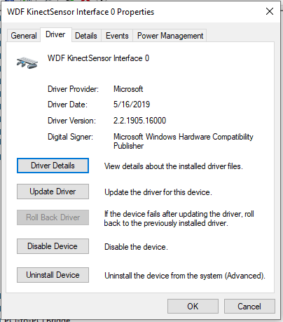

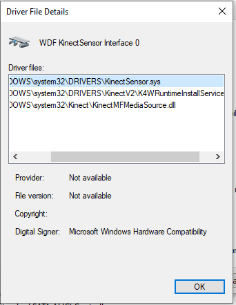

    -Updated WDF KinectSensor Interface 0 driver to 2.2.1905.16000

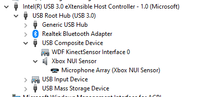

    -Checked that it is connected to an intel USB controller selecting Xbox NUI Sensor and going to View>Devices by connection shows it as being under "IntelR USB 3.0 eXtensible Host Controller - 1.0 Microsoft"

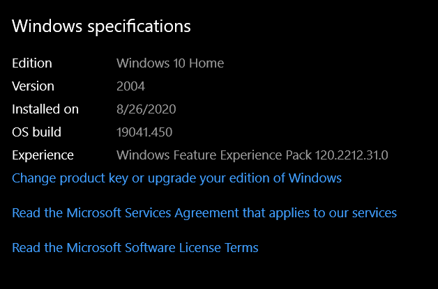

    -Updated windows from the "windows update" tab in settings

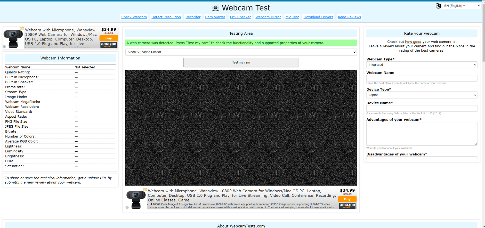

    -Tried a variety of apps, including online webcam testing sites, one of which showed an odd static for some reason

    I can't for the life of me figure out what's going wrong, since Kinect Studio V2 clearly shows me that my kinect is both successfully communicating with my machine, as well as successfully sending color video, depth video, and IR video at the full 30 fps.
