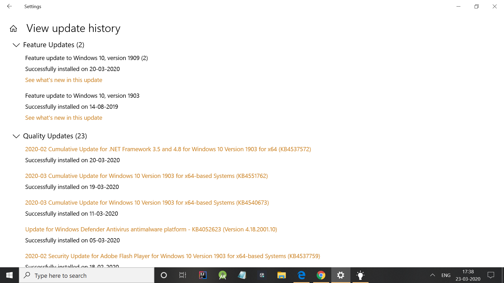

    I have an ASUS UX360CA working on a Windows 10. But lately, after my last update I think, my laptop has been shutting down in about 5 minutes after I unplug it from charging.
    It is on "Full Capacity Mode" using the Asus Battery Health Charging application.
    I tried shutting it down, unplugging it, holding the power button for 60 seconds, and then charging it, but to no avail.
    I have also tried uninstalling the battery driverACPI compliant and rebooting it, again did not work, and editing my power plan system cooling policy, maximum processor state, which failed to work too.
    I'm almost positive it's a problem with one of the latest updates.
    I'd much appreciate any insights or solutions to the problem. Thanks!
    PFA the update history. It's been about a week or two since the problem. Laptop Shuts Down when Unplugged 22e0d716-f0be-4e97-be19-6358b7db2285?upload=true.png
