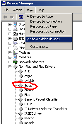

  2. Disable beep sound when plugging/unplugging laptop charger
    My laptop makes an annoying beep sound whenever I plug or unplug the charger.
    Windows 8.1/Windows 10:
    Disable the System Speaker device:
    1. Open "Device Manager".
    2. Scroll down to "System Devices".
    3. Click on "+"
    4. Right click on "System Speaker".
    5. Select "Disable"
    6. Restart your computer.
    Beep should be permanently disabled.
    Windows 7:
    Disable the Beep device:
    Source Disabling awful power cord beep?
    DavidPostill, Jan 26, 2023

    • My BIOS doesn't provide a setting for power control beep.
    • My playback device settings don't show the "PC speaker" bar, so I can't mute it.
    • I don't have the Realtek audio driver, so I can't uninstall it. When I automatically search for a new audio driver via device manager, the search won't terminate. When I donwload the driver from the Acer Support site, I am only offered the Realtek driver (which seems to be a possible cause of the problem according to some sites) which anyway fails to install.
    • My device manager doesn't show Non-Plug and Play Drivers, even after enabling "Show hidden devices", and therefore I can't see and disable the "Beep" device. According to LPChip's comment on DavidPostill's answer, in Windows 10 the "Beep" entry is labelled as "System devices" > "System speakers", so see the next bullet point.
    • Edit after DavidPostill's updated answer My device manager doesn't show "system speakers" under "system devices" (which seems to be the equivalent to the above for Windows 10), so I can't disable them. Possibly my laptop doesn't have separate system speakers so the beep comes from the normal built-in speakers, in which case I probably won't be able to manipulate something in the device manager without also affecting all other sounds.
