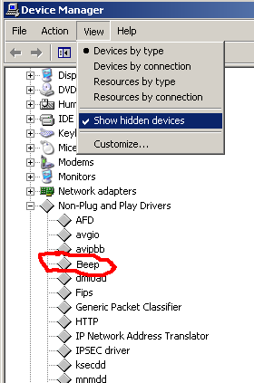

    Windows 7:
    Disable the Beep device:
    Source Disabling awful power cord beep?

    • My device manager doesn't show Non-Plug and Play Drivers, even after enabling "Show hidden devices", and therefore I can't see and disable the "Beep" device. According to LPChip's comment on DavidPostill's answer, in Windows 10 the "Beep" entry is labelled as "System devices" > "System speakers", so see the next bullet point.
    • Edit after DavidPostill's updated answer My device manager doesn't show "system speakers" under "system devices" (which seems to be the equivalent to the above for Windows 10), so I can't disable them. Possibly my laptop doesn't have separate system speakers so the beep comes from the normal built-in speakers, in which case I probably won't be able to manipulate something in the device manager without also affecting all other sounds.
