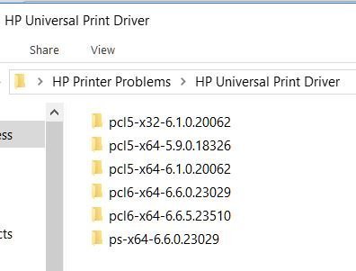

    I cannot tell if you got this message before so I am reposting it here. In regards to the HP Laserjet 1200 printer, as with the first situation, my computer recognizes the USB connected Laserjet and tries to install it, which it shows was successful, but it was not. This printer worked fine before the Windows 10 Professional reinstall that precipitated this problem.
    Below the printer in printers and devices, it says that the "driver is unavailable" (see image). So there are no drivers to uninstall or reinstall. As you can see, the 1200 shows up there but does not show up in Device Manager. When I try to "add printer" and look for the printers that are attached to the computer (as above), it does not find the 1200 printer. How can this be? Windows update does not find this model.

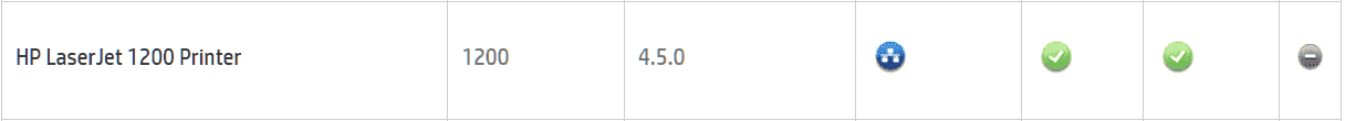

    I have all the HP universal print drivers but none of them work; according to the HP website, the UPD PCL5 or PCL6 should work (see list below). What to do?
