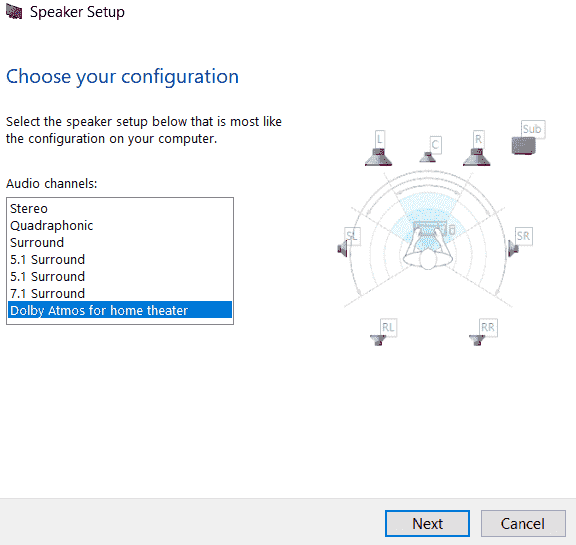

    When I reinstalled Windows 10 last week I ran it for several days before doing any updates. I downloaded and ran the Dolby Access app from the store and set up Atmos for Home Theater. It worked perfectly. Survived shutdown, sleep, hybrid sleep and hibernation. Sunday night I ran Windows update and let everything come up to date.
    Monday, no Atmos. Nothing I have tried works. When I go to the playback tab in the sound control panel, I can see that I should have it:
    Latest update seemed to have broken Dolby Atmos 1f6ad94a-9e79-4731-bfe3-213e28759e69?upload=true.png

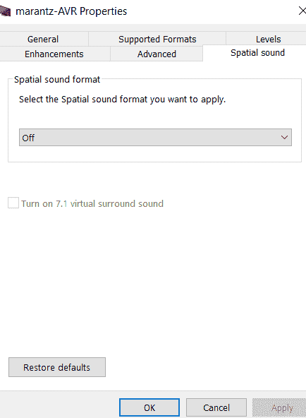

    But I run through the steps, and then when I go to the spatial sound tab in properties, it is turned off:
    Latest update seemed to have broken Dolby Atmos d5585d99-a3d0-462b-b1d5-add6dbcace87?upload=true.png

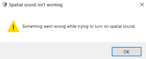

    So I turn it on, and get this:
    Latest update seemed to have broken Dolby Atmos 84dee924-1d05-402e-87f0-4a11599d605b?upload=true.png
    I have tried uninstalling the HDMI audio driver, and using the generic MS one. Reinstalling the nVIDIA one. Nothing. Changed cables (which is stupid, but I figured someone would actually believe it makes a difference and try to make me do it) - nothing. Switched to a different output on the card. The only thing I haven't done is to roll back to the fresh install, using a restore point. I'd rather not do that, but Atmos is important for me. I have also researched this a great deal and apparently I'm not the only one that this has happened to.
