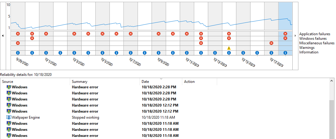

    I know that there are other posts about this error, but they haven't helped at all and most of them are outdated. I have been getting this error for months and I can't seem to find a solid solution to this problem. There doesn't seem to be a pattern or anything that I have noticed. I appreciate any help.
    Things I have tried:
    • Full Windows Reinstall
    • Clean graphics driver reinstall
    • Updating Windows
    • Running SFC and CHKDSK
    • Replacing GPU
    • Replacing my SSDs
    • And probably more that I forgot to list
    This error happens almost daily at this point as seen in reliability monitor:
    LiveKernelEvent 141 error DAILY 06e4ba2a-3897-4fbf-9ec0-2d2ef81f3e58?upload=true.png
    When it happens, my monitors go black for about 30 seconds and all applications crash/reset. I have checked the MEMORY.DMP file and this is what shows up:
