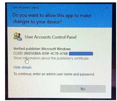

    my laptop was newly by and I change my account to local account from administrator then now my administrator was hidden
    I try several method of change CMD or Local user and Group etc
    all time it’s not allow to access and it shown below Massage I want to back may same account with administrator power
    Local Account Convert to administrator fc50deef-ba92-483e-be7d-80ad26812ccb?upload=true.jpg

    If you are a standard user account, convert to administrator user account by following the steps below and check if the issue is resolved.
    • Press Windows logo + X keys on the keyboard and select
      Control panel from the context menu.
    • Click on Change account type under User accounts.
    • Select the user account from the window and click on Change the account type.
    • Select Administrator radio button and click on
      Change account type
    • Close the window and logout from the built-in administrator account and check if the changes are effective.

    I suggest you to enable Built-in administrator user profile and create a local user account by following the steps below
    Step 1: Enable built-in administrator account.
    • Open Elevated command prompt by entering Safe mode with Command prompt.
      To go to safe mode, use the power button on the sign-in screen and press
      Shift + Restart. This will take you to the recovery boot menu. Click
      Troubleshoot> Advanced options> Startup settings.
      You then see a list where you can choose Safe Mode with Command prompt.
    • Type the following command: net user administrator /active:yes
    • Login into the built in administrator user profile and create a new user profile with administrator privileges.
    • Delete the corrupted user account from the built in administrator.
    • Then lock your screen by pressing Windows key + L, and sign-in at the
      Administrator account.
    • Check if the issue persist and you can disable built in administrator account by typing the command:
      net user administrator /active:no
      in the Command prompt (Admin).
