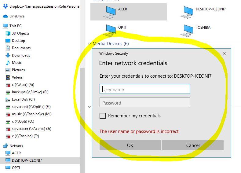

    Credentials Login issue on new computer added to small Win 10 network
    Hi
    I have had 3 computers running perfectly on a Win 10 network. Each computer can see and access each other perfectly with no logins etc required.
    But I have now added another Win10 computer but am having issues with Network Credentials being required.
    This new PC can see and access one of the others without any login. But for the others it is asking for a Network Credentials login in order to be able to access them.
    One of the existing ones can see and access the new one. The other two can see it but are requiring credentials login.
    How do I get rid of any credentials requirement on all computers.
    All are set up with full file sharing etc as far as I can see. Password protection is off on all of them and all belong to the same workgroup
    I want everything to see everything else without any logins required
    Thanks
    Login Credential being asked when I try to access my Main Computer with a new Computer over... credentialsinspiron1907.JPG.d985fa19a068742301bc9d7f6df08cb7.jpg
    RonE5, Feb 17, 2025
