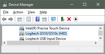

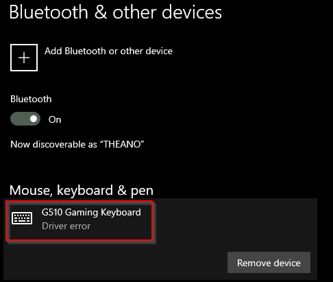

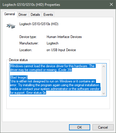

    I have a Surface Book 3, with Windows 10, 20H2 feature update, and a Logitech G510 keyboard.
    I just wanted to get advice on the best way to get this keyboard working with Windows 10. I installed the Logitech Gaming Software 9.02.65 64 bit, which is the latest software with driver for this keyboard. Note that the laptop was at 1909 feature version when I installed that.
    As it stands, the driver is reported in error.
    Logitech G510 keyboard driver issue with Windows 10 20H2 17ef1c54-f39a-492f-9e6c-0646999b4403?upload=true.png
    Logitech G510 keyboard driver issue with Windows 10 20H2 c4469916-59dd-4d59-b89c-5ad3dc2de4c6?upload=true.png Logitech G510 keyboard driver issue with Windows 10 20H2 6b6470f4-8535-4318-933b-cec6ccb8ff69?upload=true.png
    There are no later drivers from Logitech, and I am not sure they will be forthcoming, although I have submitted a request.
    Where this leaves me is that the keyboard works fine as a standard keyboard. The driver does allow the little LCD screen to work, and it does allow the programmable G keys, but only if I set them to run executables. The option to set a programmable G key to send keystrokes as a macro is not working at all any more. Also, the volume scroll wheel does not work, and the media buttons do not work. I would like to get these working with Win 10 if possible.
    The question is, what can I do to fix this issue? The keyboard was a great productivity tool, but, without the option to program the keystroke macros, it is not any use as an extended keyboard.
    Further to this, on an older Surface Book 2, playing around with it, it seems that I can get the keyboard driver FULLY working, with G key macros, volume scroll, no driver issue, media keys working, by turning off Memory Integrity in Core Isolation in Windows Security. It was a very difficult task to even turn the memory Integrity off, and I would rather not do this to the Surface Book 3.
    Is this keyboard a lost cause? Can it work again?
